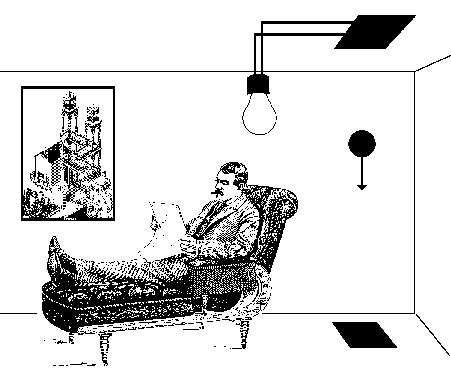

There are lots of examples on youtube ... doing vertically would be trickier but adds an extra eye-warp to it if the all you see is the ball bouncing between "floor" and "ceiling". It would make it look like this:
http://www.lhup.edu/~dsimanek/museum/unwork.htm#bbe​
