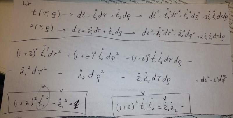

Given a specific metric, is there a easy way to transform it in Synchronous coordinates?
For example having dsigma2 = (1+z)^2 dt^2 - ds^2 - s^2 dphi^2 - dz^2 ,
I was able to do some substitutions, but I had to stop at the differential equations presented in the attachement.
Is this for a homework problem? Or a project? There is no easy way in general. If you wish to explicitly construct a set of Synchronous coordinates (which I will hereafter call Gaussian normal coordinates since this is the common name but keep in mind that Synchronous and Gaussian normal coordinates are the same thing) on a neighborhood of a point in space-time, you will end up having to solve differential equations which may or may not be tractable.
The point of Gaussian Normal coordinates is not the explicit construction but rather the existence theorem (which comes out of what is called Gauss' lemma: http://en.wikipedia.org/wiki/Gauss's_lemma_(Riemannian_geometry)). So given any event in space-time, we can always impose Gaussian normal coordinates on some neighborhood of the event and all we care about is that in these coordinates ##g_{00} = -1## and ##g_{0i} = 0## where ##i=1,2,3##. All the calculation power of Gaussian normal coordinates comes from this property so we really just care about the local existence of said coordinates for general space-time metrics. This is why I asked if you are doing this for a homework problem or a project or not. It really depends on what you want.
Recall the way Gaussian normal coordinates are geometrically constructed. We start with an initial non-null hypersurface ##\Sigma_{0} ##, and a parameter ##t##. We take a family of geodesics normal to ##\Sigma_{0}## such that in some neighborhood of the event in question, they form a congruence ##\xi^{\mu}## in this neighborhood (meaning they never intersect). ##\xi^{\mu}## will have the property that it is normal to the family of hypersurfaces ##\Sigma_{t}## gotten by evolving the initial hypersurface ##\Sigma_{0}## using the parameter ##t##, where the evolution keeps going until we are out of that chosen neighborhood on which the family of geodesics remain non-intersecting. Using the parameter ##t## as the time coordinate for our metric, and using the fact that ##\xi^{\mu}## is normal to all the hypersufaces in the family (for as long as we don't terminate ##t##), we can put the metric in the form ##ds^{2} = -dt^{2} + h_{ij}dx^{i}dx^{j}## with the same labeling scheme as before. We can also define a quantity called the extrinsic curvature of the hypersurfaces (which measures how they bend in space-time) by ##K_{\mu\nu} = \nabla_{\mu}\xi_{\nu}##. One can show that in Gaussian normal coordinates, we have an evolution equation for the functions ##h_{ij}## given by ##\partial _{t}h_{ij} = 2K_{ij}## so if you can solve this set of differential equations you can determine the explicit form of the functions ##h_{ij}## up to some arbitrary functions but as you can probably tell this may or may not be tractable in practice.
