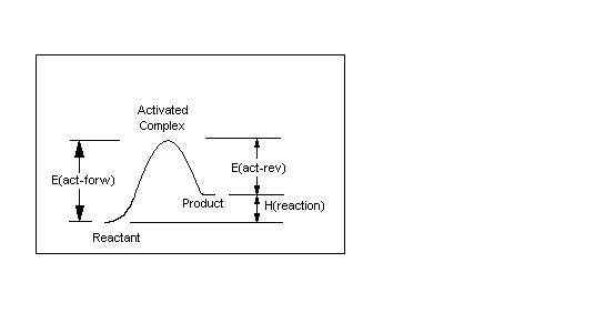

And another question I have is when I am given the activation energy for a forward reaction and I have found the heat of reaction how do I find the activation energy for the reverse reaction.
Draw yourself a energy diagram. In general (activation energy-heat of reaction), remember to use correct signs. Do you understand now?

The question.
The question is:
For the reaction
CO + NO2 --> CO2 + NO
the activation energy for the forward reaction is 135 kJ/mol of CO reacted.
Determine the heat of reactoin
Determine the activation energy for the reverse reaction
Draw and label a potential energy diagram for the reaction
... if anyone has any good sources on drawing potential energy diagrams, I'm sure I can take it from there, but I'd also like to know how you get the heat of reaction..is it through the diagram? or through an equation? I'm lost in that part of the question and I have no text to support me, thanks again.
You'll need find each compound's standard enthalpy of formation, which should be listed explicitly in your text. From this you'll need to find the net standard enthalpy of reaction. The rest should be simple.
I don't understand why you're having such a difficult time finding a energy diagram, I'm quite positive that they should at least have an example in your text.
Your text should also describe the general process on how to finish up this whole problem. You don't even need directions, one peek at the energy diagram and you should be able to figure everything out.
That's exactly the problem, I do not have a text, I am doing an independent learning course to get my Chem 12 credit. When I went to apply they gave me the booklet with the questions, which constantly tells me to read certain pages in a textbook, unfortunately they also told me that I would not be able to get this textbook from them because they are out of stock. Quite a stupid system if you ask me... to learn from a book that might as well not exist. Anyways, I guess I'll just try to look up the process on the internet as I have been with all the other questions. I just find it tedious because a lot of the websites present only general information without having in depth explanations to the processes of actually getting the answers. Thank you for your help though, I'll try to use the enthalpy stuff to figure this out.
[tex]E_{act} (forward) = E(AC) - E(Reac)[/tex]
[tex]E_{act} (reverse) = E(AC) - E(Prod)[/tex]
[tex]\Delta H(rxn) \equiv E(Prod) - E(Reac) = E(Prod) - [E(AC) - E(AC)] - E(Reac) = E_{act} (forward) - E_{act} (reverse)[/tex]
