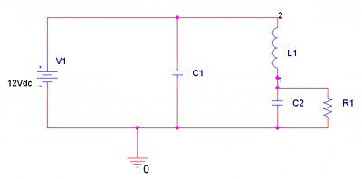

I think the diagram that I have attached achieves that, I did not test it properly in pspice though. The DC source represents your full wave rectification and the voltage across R1 should be smoothe enough

Exequor: What is L1? I'm not very good at this so can you please explain a bit how your circuit works?
Cheers
