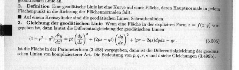

I don't understand the equation of the geodesic y=y(x) for the surface given by z=f(x,y) :
[tex]a(x)y''(x)=b(x)y'(x)^3+c(x)y'(x)^2+d(x)dxdy-e(x)[/tex]
the functions a,b,c,d,e are here not very important, what I don't understand, is that there is terms in [tex]\frac{dy}{dx}[/tex] and [tex]dxdy[/tex]...What does this mean ?

This is the equation in the special case where z=f(x,y)...the geodesics being given in the direct form : y=y(x)...I got this in Bronstein Taschenbuch der Mathematik.

Here is a scan :

It's a typo,i'm sure the German dude meant the derivative of the first order
[tex]\frac{dy}{dx}[/tex].
