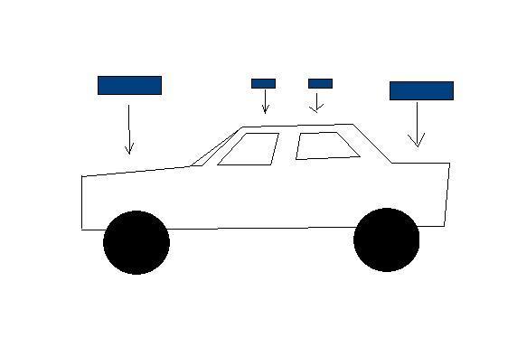

I was thinking more along the lines of that in this little drawing of said "car".
koop117 said:
(What if) I use small solar cells for that task (I know, energy would be used faster than converted by the panels, but it could possibly lengthen battery life per charge, right)?
IF they can be properly setup (no releasing magic smoke as faust9 pointed out) they would assist a little yes, but the cost is typically prohibitive.
As said, the alternator is a bad idea and would only waste energy.
And as far as rengenerative braking is concerned, from what I've read its not a very efficient method of energy capture. Maybe if you could just always find a way to go downhill...because otherwise it will take far more power and create more losses going up the hill then could ever be recovered braking on the other side.
