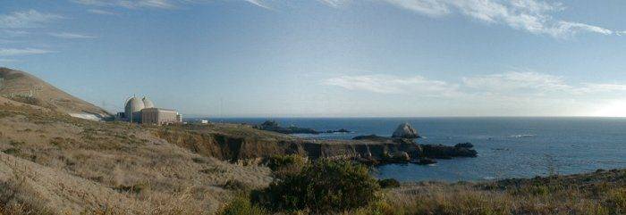

San Onofre Unit 1 was of an older design (first generation) and of very small capacity. It eventually became uneconomical to keep it running, as the maintenance and repair costs continuously crept higher (it was also determined to be economical to shut it down before the older employees, who had the most experience with that reactor, retired).
Conversely, Diablo Canyon's two units are the most advanced reactors online today in the United States, and they seem to be cost-effective.
http://www.zimfamilycockers.com/DiabloCanyon.html
The average cost of electricity produced in California is over 3.6 cents per killowatt/hour... but Diablo Canyon power costs less than 1.6 cents per kWh.

Morbius,
What are the two blue pools for? Do they hold emergency cooling water?

hitssquad said:
Morbius,
hitssquad,
Or at least water that can also be used for emergency cooling.
http://www.nucleartourist.com/us/diablo.htm
lists the emergency water sources; one of which is called the
"raw water storage reservoir". This source is listed at 4.5 mega-gallons.
I would bet it is for general water use - but is available in an emergency.
It also appears to be at a higher elevation than the reactors - so gravity
can be used in lieu of pumps.
Dr. Gregory Greenman
Physicist
Morbius,
Thanks for the info. Yes, those pools look to me like they hold about 4.5 million gallons. That's a great picture of Diablo Canyon, BTW.
hitssquad said:
Morbius,
Yes - it was taken from a helicopter flying up and down the California
coast - the same people that Barbara Streisand unsuccessfully sued
because they took a picture of her coastal estate in Malibu.
Physicist
