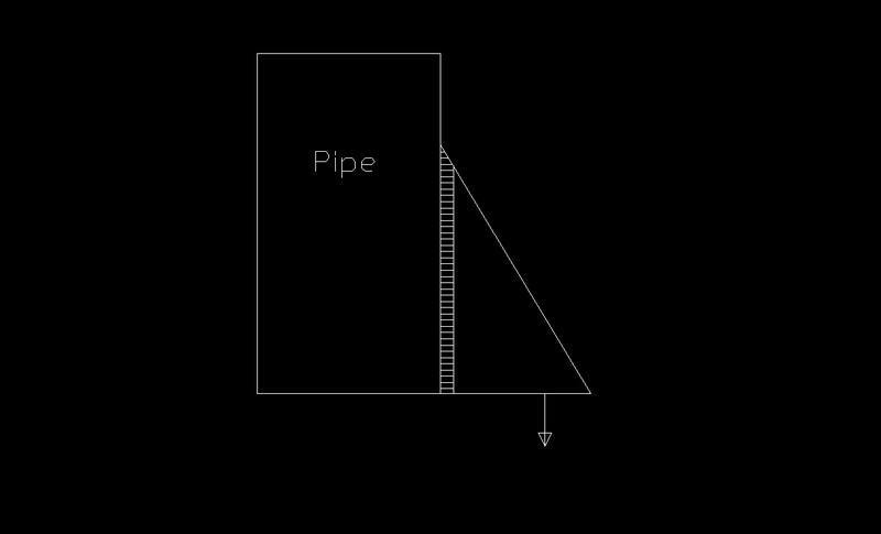

This is kinda hard to explain without a drawing but I'll try. Imagine an L-shaped structure with a weld going down the vertical part connecting the L to a vertical pipe on the left side of the L. The curvature of the pipe is insignificant. Then on the L's right end is a vertical downward load. I find that I have a [tex]\tau_\|[/tex]. This I can see, since the weld is being "streched" in a parallel direction, but my book also tells me that [tex]\sigma_\bot = \tau_\bot[/tex] is also part of the problem, and I am not able to see why this is...can someone please help me?

Well the L has a downward force on the horizontal arm, which induces a shear in the weld. But the downward force at the end of the arm produces a moment at the vertex of the L, i.e. where the vertical and horizontal parts meet.
The question is why the equivalence [tex]\sigma_\bot = \tau_\bot[/tex], I imagine. I'll have to think about it.

The L part will be wanting to rotate about it's 'elbow', causing the welded seam to pull radially outwards on the pipe.
Yes, that might be it. The question Astronuc is not why [tex]\sigma_\bot = \tau_\bot[/tex], but why they are there at all. As far as I can see the weld isn't exerted by any perpendicular force, only paralell, as noted by [tex]\tau_|[/tex]. But since the force will try to turn the whole thing around clockwise, that might cause some "perpendicular-like" force...or?
Yes TSN.
Imagine the L is just attached at its base. If you apply a force downwards on the _ of the L, the member will rotate clockwise about the left hand side of the _.
As a result, the weld provides a force on the L, acting towards the centre of the pipe.
If you're still stuck, read up on couples and moments.

Something like this -
L______V
I believe the bending moment is greatest near the right angle in the L, and it should fall off.
Basically the weld provides a distributed load on the vertical branch of the L, and the vertical load at the end of the horizontal arm is a pointwise load.
Distributed load on vertical arm
and a moment at the right angle.
... I'm getting this the same way ... applied load is shear with respect to the "L's tip", the shear causes a moment to the pipe, the moment in the pipe causes a support reaction, and the support reaction is a shear load as far as the pipe is concerned. I think the notion about the equality in | and -- can make sense if the "support span" in the pipe is equal to the "length" the L ... this way I think the shear forces will be equal in both directions (but stress wise needs some further thought if we're using e.g. beam theory ... shouldn't result generally but rather a specific result...).
So to wrap up, would it be correct to say that we have a component [tex]\tau_\|[/tex] initially, but because the downward force tries to rotate the L-shape clockwise, this results in a perpendicular force on the weld, namely [tex]\sigma_\bot[/tex] or [tex]\tau_\bot[/tex] if you will. If someone confirms my thoughts on this I'll be so happy! :smile:
Pretty much, yes.
I don't know any of the math, but my approach if I had to build the thing would be to think of the angle of the 'L' as a hinge attached to the pipe. Then you can do whatever number stuff you have to do in order to figure out the 'pull-away' force at the top by leverage formulae. Then factor in that the weight would also be trying to slide the whole thing down the pipe, which I guess is the 'sheer'. When in doubt, use bolts instead.
