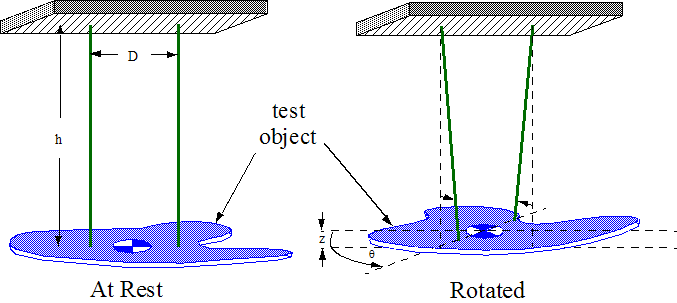

The expression for the period of the bifilar pendulum is the same as the sinfle string pendulum $$T=2\pi\sqrt{\frac{L}{g}}$$ Of course here ##L## is not the length of the strings but the vertical distance from the point(s) of support to the horizontal level of the swinging mass.

These pendulums are used to measure the moment of inertia of objects and they oscillate in the horizontal plane in that case, not in the vertical plane.

I have seen the term bifilar pendulum to refer to the situation with two separate strings not meeting at the CM and the pendulum is oscillated around the vertical axis in the horizontal plane. Then the period is a function of the moment of inertia.
Yes, that's the torsional bifilar pendulum. However OP is referring to swings which implies motion in a vertical plane not rotations about a vertical axis. Here is the interesting hybrid of "Y" suspension that provides a good basis for an experimental investigation of pendulum motion.
