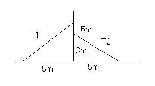

i have a problem i have having trouble solving, it reads as follows:
a vertical pole is supported by two ropes, each 5m from the base of the pole. The rope to the right of the pole extends 3m up the pole, and the rope to the left of the pole extends 4.5m up the pole. The ropes and pole lie in the same vertical plane. The mast cannot provide any moment of force about its base. What is the ratio of the tension of the two supporting ropes, where the tension is marked as the hypotenuse of the two triangles formed on each side of the pole?
I realize that for the pole to remain in equilibrium, the forces acting on it must have a vector sum of zero, and the sum of the moments of force must also equal zero. I have found the forces acting on the pole at the point of each ropes attachment, and are 10N for the lower rope on the right, and 6.67N for the higher rope on the left. Is the ratio between these forces the same as the ratio between the tension on the ropes?
Any help would be greatly appreciated, thanks.

i made a lazy sketch here. maybe this is what you meant?

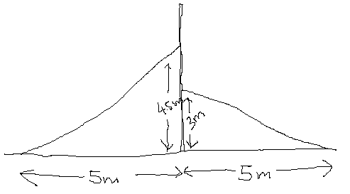

Sorry, here is the diagram... my description skills arent the best..
I have been working on this problem to no avail... can anyone help? So far i have tried to find the horizontal component of the forces using the formula F1+F2=0 (since the pole is in equilibrium, the sum of the vector forces will be zero, as will the sum of the vector moments of force) so also: rxF1+rxF2=0. Since the distance from the axis of rotation to the force is just the distance up the pole i got: 4.5F1+4.5F2=0, but have no idea what to do with this equation. Any one help?

I am very very sorry, I forget the friction force. :blushing: My posts above are wrong. Sorry...
Let's say the pole base is O. The moment of 2 tensions relative to the point O must be the same to keep the pole from falling. The P, N, and friction force go through O therefore create no moment.
Call r1 the distance between O and T1, r2 the distance between O and T2.
You have:
[tex]T_1r_1 = T_2r_2[/tex]
Call the length of 2 rope are l1, and l2. You will have:
[tex]r1 = \frac{5 \times 4.5}{l_1}[/tex]
[tex]r2 = \frac{5 \times 3}{l_2}[/tex]
So you will have:
[tex]\frac{T_1}{T_2} = \frac{r_2}{r_1} = \frac{3 l_1}{4.5 l_2} = \frac{\cos \beta}{\cos \alpha}[/tex]
I am sorry if I did make you confused...
P.S : I felt sooo ashamed of myself :cry:. Please read this post, the posts above are sooo wrong... I think I'll get some sleep now. I forgot to consider the friction force. The friction force also has the horizontal component. Without the friction force, this pole can never stand. Sorry again. Hope you are not mad at me...
Viet Dao,
I am just curious as to what the moment arm is; what is r1 and r2? Are they the distances from the ground where the ropes meet to their point of joining on the pole? No i am not mad at you, and thankyou very much for your help Viet Dao. I am also curious where you get the equation [tex]r1 = \frac{5 \times 4.5}{l_1}[/tex] from?
It's the distance between the point O (the pole base), and the 2 ropes.
In the right triangle ABC, angle BAC = 90, AH is its altitude, you will have:
[tex]2S_{ABC} = AB \times AC = BC \times AH[/tex]
So [tex]AH = \frac{AB \times AC}{BC}[/tex]
