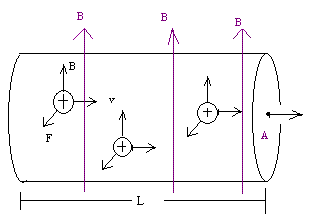

Example of my Queston.
Tide said:
Aladin,
Why don't you give an example or two of the kind of situation you're talking about? That would make it easier for people to share what their thinking would be in approaching a new problem.
It is an example of my question.
I is taken from the Chapter-Electromagnetism.
The topic is. “Force on a moving charge in a magnetic field”
Calculation of force on a moving charge in a magnetic field.
Force on a current carrying wire of length L in a magnetic field FL = I(L*B) -------- (1)
Here I have a confusion that is .
How we came to know that to find the formula, first we have to find out the total charge carriers in AL (volume) ?
Let.
Number of charge carriers in unit volume = n
Volume of a wire segment = AL
Number of charge carriers in AL Volume = nAL
Similar Reason?
Let
Charge on one charge carrier = q
Total charge Q = nALq
Now
Time = Distance/Velocity
t = L / v Here: why we find out time.?
We know that
I = Q / t Why we use I = Q / t to find current ?
I = nALq / L /v
I = nAqv put in equation (1)
Total force F =nAqvL*B --------- (2)
As L & v are in same direction
Why we took this step of unit vectors.?
So
L^ = v^
Hence
vL = vLL^
vL = vLv^
vL = Lvv^
vL = Lv
Equation 2 Becomes
Total Force FL = nAqLv*B
Let force on one charge carrier = F
Force on nAL charge carriers = nAL*F
Total force F = nAL * F
F = F / nAL
Put the value of F
F =nAqLv * B / nAL
We get
F = q v * B

The problem is to calculate the force acting on a current carrying wire in the presence of a magnetic field. You need to know a few things before you can solve the problem.
First, you have to know that a magnetic field produces a force on a moving charge. This is the Lorentz force and you would have to know that the magnitude of the force is the product of the charge, the speed of the charge and the strength of the magnetic field. The direction of the force is perpendicular to both the magnetic field and the direction in which the electron is moving.
That applies to a single charged particle so the next question is what is the net force on a collection of moving charges since that is what we mean by electrical current. The answer is that the net force acting on the wire (or current) is the sum of the forces acting on the individual charges. (In this case, only the electrons are moving.)
So we need to find a way of relating electrical current (which we can measure) to the number of electrons and their speed. The electrical current is the charge carried by number of electrons that pass by a given point in a period of time. Let's see where that leads us.
Suppose the electrons are moving with speed v and that there are n electrons per unit volume. How many of those electrons pass by a given point in some period of time? Imagine you could put a mark on the wire as a reference point and that you can take two photographs of the electrons, one at t = 0 and a second a short time later, call it t = T. Your photograph will show that the electrons that started out at your reference point will have moved some distance along the wire and, since we know the speed and the time the distance they traveled was just vt! Meanwhile, other electrons had moved in behind those advance electron to fill the space behind it.
How many electrons crossed your reference point? That would be all the electrons that now (in your second photograph) fill the space between those leading electrons and your reference point. Since we know there are n electons per unit volume and if the wire is uniform then the number of electrons that passed your reference point will be
[tex]n \times A \times v \times T[/tex]
which represents the number of electrons per unit volume times the volume occupied by all the electrons that passed by your reference point during the interval of time T and A is the the cross sectional area of the wire. Now, just divide by T and multiply by q and you have the electrical current!
[tex]I = n \times q \times A \times v[/tex]
Now, let's return to the first part. The magnetic force on a single charge is qvb (assuming the electrons move perpendicular to the field). The total number of electrons in the length of wire is nAL so the total force on all the electrons is nAL times qvB or
[tex]F = nAL \times qvB[/tex]
But, naAv is just the electrical current so
[tex]F = ILB[/tex]
You can generalize the argument if the wire is not perpendicular to the magnetic field.
Is this what you were asking for?

Draw a current cylinder of length l that the charge q travels in 1 sec.
Look at the diagram and see that qv = Il ... units: [Cm/s = C/s *m].
Now that you know this, remember one, and replace if need be.
