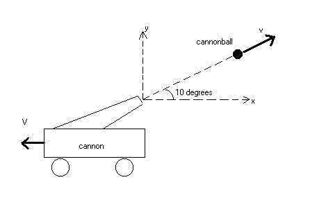

Ok, don't ask why I was doing this dynamics problem from an old textbook, but, I cannot get the answer to match that in the back of book and it's a simple problem.
Here it is, a cannon weighing 400 lb, fired a cannon ball weighing 10 lb, and had a muzzle velocity of 200 ft/s. For a 10 degree elevation angle, determine the velocity of the cannon after it was fired?
My immediate though was conservation of linear momentum, with Mc*Vcx + Mb+Vbx = 0, where the subscript c, b, and x are cannon, cannon ball, and horizontal direction, respectively.

I think, the elevation of the barrel is 10 degree but the shot is not leaving the barrel at 10 deg. with the horizontal because of recoiling of the gun. The angle of projection is more than 10 degree with horizontal and hence Vbx = 200*sin(10^o) is not correct.
moreover the horizontal component is not sin@ but cos@.
Muzzle speed is relative to the berral
The book is giving correct answer.

Conservation of momentum in the x direction requires (absolute values):
mxv=MxV
which leads to:
V=[cos(10°)x200ft/sx10lb]/400lb=4.924 ft/s
Now… what about the vertical (i.e. y) v-component? The mxvxsin(10°) momentum seems to have no "counterpart"

During the process of firing, the cannon starts recoiling and acquirs a velocity [tex]v_c[/tex] and hence the velocity of ball relative to Earth in horizontal direction after leaving the cannon will be [tex]v_b\cos \theta - v_c[/tex]
The vertical component of velocity will remains the same that is why the angle of projection will be greater then the angle of elevation of the barrel, as I gave in previous posting.
Now conserving the linear momentum
[tex]m(v_b\ cos\theta - v_c)\ = M v_c[/tex]
gives
[tex]v_c = \frac{m v_b cos\theta}{M + m}[/tex]
= 4.8 f/s negative is due to direction, arrange.
It is a well known problem asking about the direction of the ball leaving the gun. :smile:

The sin cos thing was a typo but the velocity difference is essential to conserving the location of the center of mass of the system (ie. conservation linear momentum). I can't believe I missed that,
