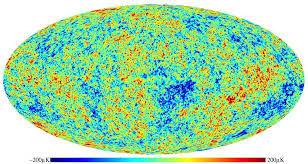

Now, in addition to ultimately giving rise to structure, the first thing the primordial perturbations did was imprint themselves on the CMB, observable today as temperature anisotropies. Now, the CMB today comes to us from all directions, appearing to emanate from a giant sphere with Earth at the center. The inside surface of this sphere -- the so-called last scattering surface, is what we measure with our satellites. It is this surface that is cut open and spread out to form the spectacular WMAP images like this one:
Full-sky map in Mollweide projection of the cosmic microwave background temperature, with a colour bar running from -200μK in blue to 200μK in red, showing mottled hot and cold patches.

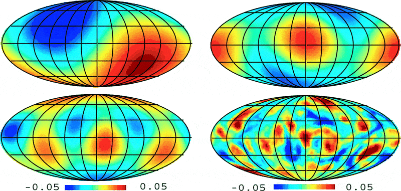

The beautiful curve to which you refer, is a way of representing the degree of clumpiness of this map, much like the correlation function measures the clumpiness of 3D structures in today's universe. But, since the CMB sky is really a spherical surface, we use the angle [itex]\theta[/itex] between points on the sky to parameterize the correlations. And we can likewise take the Fourier transform of this temperature correlation function, just as we did for the 3D correlation function, and we obtain the temperature power spectrum, but this time parameterized in terms of multipole number, [itex]\ell[/itex], instead of k. Here, small [itex]\ell[/itex] corresponds to large scales (small k). So, for [itex]\theta=90[/itex] degrees, we are measuring correlations on very large scales, in fact, on scales of order the size of the observable universe. These are the largest scale correlations known, the quadrupole. As we move to smaller angular separations, we observe the octupole, and higher multipoles. Here are the first few multipole moments:
Four Mollweide-projection sky maps in a 2x2 grid, each with a colour scale from -0.05 (blue) to 0.05 (red) and latitude and longitude grid lines; the top-left map shows broad, large-scale blue and red hemispheres, while the bottom-right map shows much finer, small-scale patches.
So the CMB sky is really built up out of all of these fluctuations, each multipole moment giving the amplitude of the correlation on a different scale. That's what your curve is showing -- the amplitudes of these fluctuations as a function of angular scale on the CMB sky. It is the Fourier decomposition of the CMB temperature fluctuations on a spherical surface. I've not included the relevant math here for brevity and since I don't want to overly complicate things. In summary, we have a primordial power spectrum, [itex]P(k)[/itex], that describes the scale dependence of the amplitude of the initial perturbations. These give rise to temperature fluctuations in the CMB, which are described by another power spectrum (the [itex]C_{\ell}[/itex]'s). Of course the two power spectra are related: the temperature power spectrum is the primordial perturbation spectrum as an adolescent, after the fluctuations have grown and evolved somewhat, projected onto the sphere.
