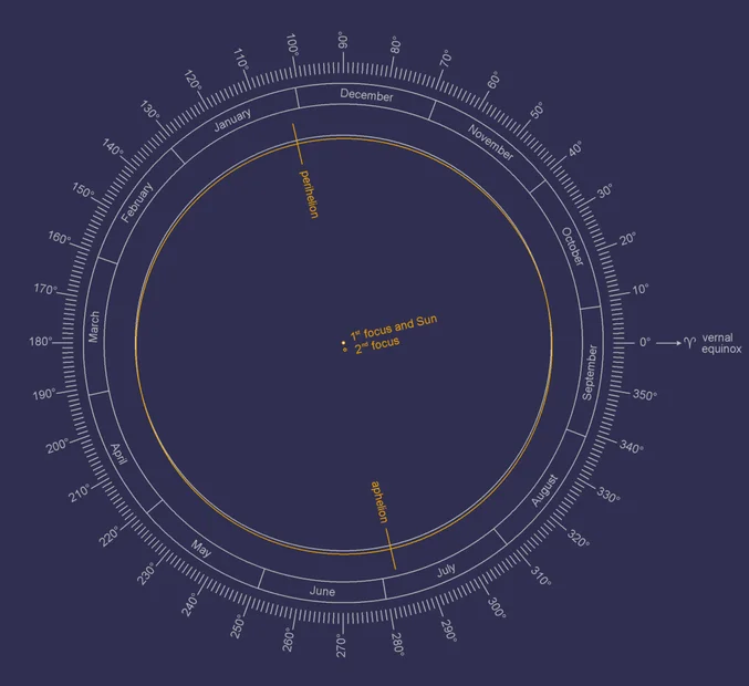

Good drawing of Earth's orbit for model? Possibly vector file?

Does anyone know where a 2D drawing of the earth's orbit can be found?
I would like to create a 3D printable model of the earth's orbit around the sun and slice it into the months of the year. So basically a calendar. Except I wanted to add heights for relative local weather conditions for a given year. Does anyone know the best way to draw our orbit?

renormalize said:
How visually noticeable do you consider that?
Wikipedia's page on Earth's orbit has a nice drawing that might aide in that assessment:
https://en.wikipedia.org/wiki/Earth's_orbit#/media/File:EarthsOrbit_en.png

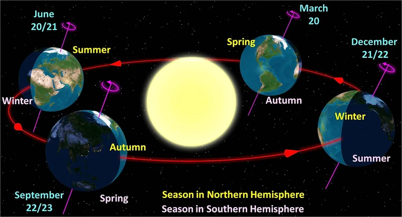

It's crude and not-to-scale in space, but this might be qualitatively helpful:

The diagram in #8 show the yellow orbit of Earth with the Sun fixed at the filled yellow dot near the center. The white circle is centered on the Sun with a (constant) radius that reflect the mean (average) Sun/Earth distance, thus making the annual variation of the Sun/Earth distance much easier to spot.
The month division along the orbit show where Earth is during that month, relative to the direction in space called the vernal equinox, which again is defined as the direction in space as seen from Earth towards the Sun at the time where the Sun passes the Earth equator towards the north. This direction acts as a reference direction when describing other Sun-orbiting objects relative to the Ecliptica (Earth orbit plane).
So, for example, around July 1st the Sun will have a longitude of around 100°. Note that the diagram arbitrarily has chosen 0° to be towards the right. You can rotate the whole diagram as you like without changing its meaning.
I am still not sure exactly what aspects you would like your model to reflect, but if you want it to show the "reason" for seasonal variations in 3D, so to speak I still say you probably want to somehow indicate the orientation of the equator along the orbit, e.g. something like illustrated below. Here the red ellipse corresponds to the yellow ellipse in the other drawing and you can see the Earth is tilted (around 23.4°, called the obliquity of the Ecliptic) and the seasons on the two hemispheres can be "deduced" from the amount of Sunlight they receive at the four shown positions.
https://en.wikipedia.org/wiki/Earth's_orbit#/media/File:North_season.jpg:

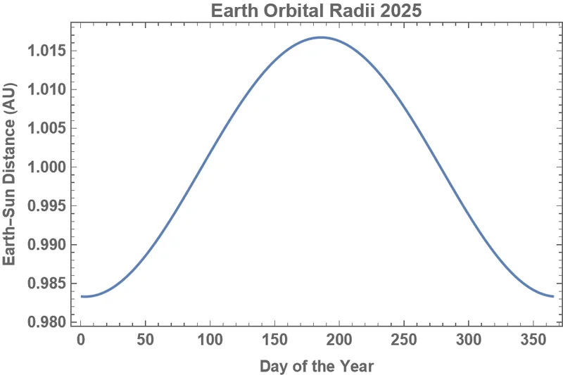

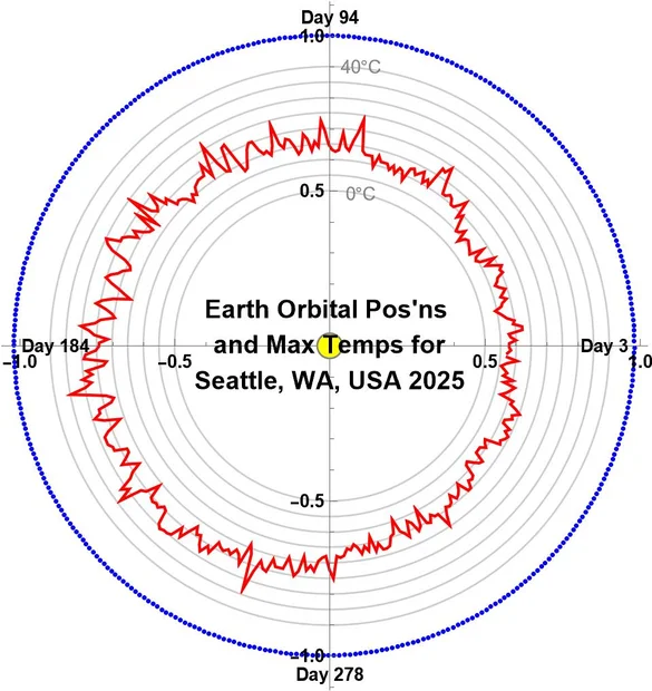

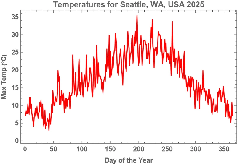

I've thought a bit more about it and decided to use Mathematica to investigate your question, as I understand it. Since you haven't specified the location of the weather data you want to use, I arbitrarily chose to download (from NOAA) 2025 daily maximum temperatures for Seattle, Washington, USA, along with daily Earth-Sun distances (from NASA), and plotted the data:
Clearly the daily temperatures are indeed roughly correlated with the Earth-Sun distances. So let's now convert the data to a polar form. From the daily radii, I used the well-known equation for elliptical orbits to extract the polar angle of the position of the Earth relative to the Sun for each day in 2025, plotted below as 365 blue dots:
Based on my interpretation of your question, I also show Seattle's maximum temperature day-by-day as a separate red "height" plot around the inside of the orbit. My comments follow:
  • Perihelion (minimum Earth-Sun distance, slightly less than ##1\text{AU}##) occurs on Day 3.
  • Aphelion (maximum Earth-Sun distance, slightly more than ##1\text{AU}##) occurs on Day 184.
  • But visually, the Earth's elliptical orbit is almost indistinguishable from a perfect circle, leading me to question whether it's really worth the bother to plot the actual ellipse, as I have done above.
  • And in my view, the patterns of daily distances and temperatures are better conveyed by the first two simple rectangular plots instead of the polar plot.
But perhaps I am not the intended audience for what you seek to accomplish.

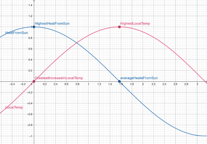

Remember that when the heat from the sun is highest, the Earth temperature will increase the most, but not be the highest. It will continue to increase more although the increases will be smaller.
You should be looking for a "time-lagged" correlation like this, where the peak effect is 1/4th of a cycle later than the peak of the cause:
You will find that "cause-effect" correlation if you look at a local temperature versus the angle between the normal to the Earth surface and the Sun direction. The hottest days of the summer are months AFTER the longest days of the year. With some work, you can get that for a particular Earth location from the information in @Filip Larsen 's post#8.
ADDED: If you still want to see the local effect of the shape of the orbit, you should first remove the larger effect of the tilt of the Earth's axis. In both cases, you should look for a highest temperature that is 1/4th of a yearly cycle (3 months) later than the peak causal effect.
ADDED2: If you are interested in other effects that are directly caused by increased temperatures, you might expect a further delay. Suppose you are interested in the height of crops. The situation might be: cycleOfTiltTowardSun => pi/4 delay => cycleOfLocalTemp => pi/4 delay => cycleOfCropHeight
