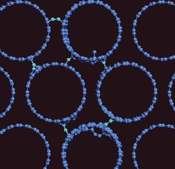

The main problem with carbon nanotubes is the difficulty with growing them long enough to be of any use. After doing some research, I found a site about carbon nanotube rings. So it got me thinking, why not, instead of trying to grow them long and interweaving them, form rings out of them and interlock the rings together. This would make sort of like a nanotube chainmail, with each nanotube ring being interlocked with many other rings. Here is the site about rings:
http://www.research.ibm.com/nanoscience/rings.html
And they also have this interesting pdf. If you look in Figure 1e you can see two interlocking nanotube rings, so interlocking them is possible.
http://www.research.ibm.com/nanoscience/Martel_Rings.pdf
If this could work, then they wouldn't need to be made nearly as long, and one would think you would still get much of the mechanical strength because you have to break the bonds between the carbon atoms (which is the strong part) to pull the rings apart. What do you guys think?

Well you have to make the nanotubes long enough to weave into a pattern. You can't weave nanotubes that are only a few nano/micrometers long because you would need something to hold them together which would make the strength of the material significantly less than a SWNT.
Carbon nanotubes are touted for their strenght and stiffness all the while being ultralite. My guess is you would lose a lot of the mechanical strength by going to a chainmail configuration.
No materials so far has even come close to the strength of a single nanotube, because, like I said above, you have to hold them together with something. So your choices are either some kind of an epoxy (which severely limits the strength), trying to bond the individual nanotubes together (which also limits the strength because they are only held together by weak Van Der Waal forces), or growing of them of sufficient length so they span the entire length of the material (which is much stronger because it requires breaking the individual nanotubes, the strong part). The chainmail idea is another alternative, which, like the last one, requires breaking the sp2 bonds between carbon atoms in the nanotubes for the material to yield. Now if someone working on nanotubes could just tell us if this is feasible...
I just a did a little reading and it looks like someone has done something similar (crosslinking the nanotubes via irradiation to increase the mechanical strength of bulk nanotubes).
http://www.nature.com/cgi-taf/DynaPage.taf?file=/nmat/journal/v3/n3/full/nmat1078.html

I guess I really don't know. Thing is though, if you could join the ends of one strand to make a ring, you could also join the ends of two strands to make a longer one. Either way, if they really can make them in quantity, that's a pretty big deal. My carbon nanotube composite shaft driver will be light as a feather. :biggrin:
CrazedMathematician , i looked at the first url you provided and i was surprised that the nano rings weren't as symetrical as i would have thought..
