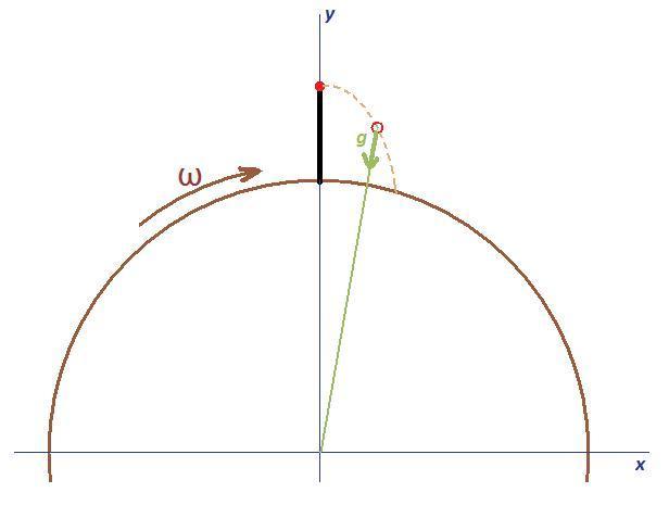

Suppose we choose our inertial frame to be comoving with the center of the Earth and origin at the center of the earth. Then, in our inertial frame, the Earth is rotating about the origin of our coordinate system.
At the moment the stone is dropped, suppose the tower is coincident with the y-axis of our inertial frame. At this moment the ball and tower are moving in the x-direction with a velocity of about 1000 mi/h, with the ball moving about 6 mm/s faster than the base of the tower! As the ball is in free fall, it will pick up a negative x-component of acceleration of gravity as shown in the attachment. (Note how the green acceleration of gravity vector has a negative x-component.)
Thus, the ball does not travel as far in the x-direction as you would expect if you neglect this x-component of acceleration.

Calculating the negative x component
I don't know how to calculate the x component, since the acceleration isn't steady.
I will try. according to the attached drawing:
The accelaration is in the x direction.
[tex]a=g\cdot\sin\theta=g\sin(\omega t)[/tex]
The constant acceleration formula:
[tex]x=\frac{1}{2}a\cdot t^2[/tex]
[tex]dx=\frac{1}{2}g\sin(\omega dt)\cdot dt^2[/tex]
[tex]x=\frac{g}{2}\int_{0}^{4} \sin(\omega t)\cdot t^2[/tex]

  • Diagram of a vector g pointing straight down, resolved into a horizontal and vertical component at angle θ from the vertical, drawn inside a circle with dash-dot axes.

The x-component of the acceleration of the stone is ##a_x = -gsin(\theta) = -gsin(\omega t) \approx -g\omega t## using the small angle approximation sinθ ≈θ.
So, the x-component of acceleration is just proportional to ##t##. So you can easily integrate it to find the horizontal distance x traveled by the stone.
You will need to take into account that the initial velocity of the stone in the x-direction is ω(R+h) where R is the radius of the Earth and h is the height of the tower.
To the level of approximation that you need, the base of the tower moves in the x-direction a distance Rsinθ ≈ Rθ = Rωt.
You want to find the difference between the x-distance traveled by the stone and the x-distance traveled by the base of the tower.
Still not good
The result, according to the book, and the non-inertial frame should be around 1.5 centimeters.
I integrated [itex]-g\omega t[/itex] and got 0.58[cm].
I subtracted that from the 2.3[cm] result which i got from the difference in velocities at the top and the bottom of the tower and got 1.72[cm].
According to the book i should get 1.5[cm].

Karol said:
Another way to solve it is to integrate the difference in angular velocity during the fall.
There is a conservation of angular momentum:
Yes, that should work, too.
From integrals tables:
[tex]\int\frac{dx}{a+bx^2}=\frac{1}{\sqrt{ab}}arctg\frac{x\sqrt{ab}}{a}[/tex]
But: [itex]b=-\frac{g}{2}[/itex]
So, under the square root there is a minus sign.
I cannot use that integral, do i?
Since b is negative, write the integral as
[tex]\int\frac{dx}{a-|b|x^2}[/tex]
See integral #22 here .
Again integrals
But the first integral:
[tex]\frac{dx}{(a+bx^2)^2}[/tex]
I cannot use it since there is a + sign in the denominator.
I didn't find an integral:
[tex]\frac{dx}{(a-bx^2)^2}[/tex]
Let ##u = \sqrt{\frac{b}{a}}x## and reduce the integral to a constant times ##\int{\frac{du}{(1-u^2)^2}}##
Then let ##u = \sin \theta## and see #26
Since ##bx^2## is much smaller than ##a##, you can get a very good approximation by noting ##\frac{1}{(a-bx^2)^2} \approx \frac{1}{a^2}(1+\frac{2b}{a}x^2)##. So, you can just integrate the latter expression.
jambaugh said:
One is adopting the accelerating frame which rotates with the earth, Coriolis is then an effective force; and the other adopts an inertial frame, moving with the surface tangentially and thus has an added velocity atop the tower.
Moving with surface tangentially is also an accelerating frame that rotates with the earth, no?
You must have meant a fixed frame, no? that is what an inertial frame is, no?
