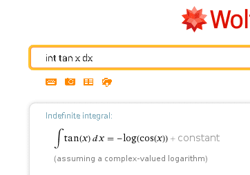

$$u(x)=\exp\int \tan x \, dx = -e^{\ln(\cos x)}=-\cos x$$ok just want to see if this first step is :cool:$\tiny{\color{blue}{From \, Text \, Book: \,Elementary \, Differential \, Equations \, and \, Boundary \, Value \, Problems \,

$$\mu(x)=\exp\left(\int \tan(x)\,dx\right)=e^{\Large\ln(\sec(x))}=\sec(x)$$
something fishy?
$$-\ln(\cos(x))=\ln\left((\cos(x))^{-1}\right)=\ln(\sec(x))$$
