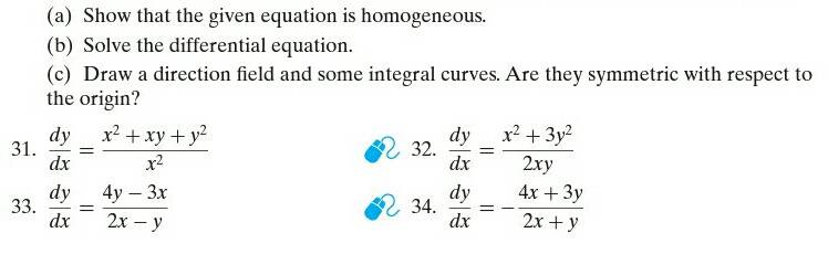

OK going to do #31 if others new OPs
I went over the examples but?
well we can't 6seem to start by a simple separation
I think direction fields can be derived with desmos
You want to begin by writing:
$$\frac{dy}{dx}=1+\frac{y}{x}+\left(\frac{y}{x}\right)^2$$
Next consider the substitution:
$$v=\frac{y}{x}\implies y=vx\implies \frac{dy}{dx}=x\frac{dv}{dx}+v$$
So, make the substitutions and simplify...what do you get?
Since the first part of the problem is to "show that the given equation is homogeneous" it helps to know what "homogeneous" means here! A differential equation is said to be "homogeneous" if and only if replacing both "x" and "y" by "tx" and "ty", where t is an arbitrary (but non-zero) number, gives exactly the same equation. Of course [math]\frac{d(ty)}{d(tx)}= \frac{dy}{dx}[/math] while replacing x and y in [math]\frac{x^2+ xy+ y^2}{x^2}[/math] by tx and ty gives [math]\frac{(tx)^2+ (tx)(ty)+ (ty)^2}{(tx)^2}= \frac{t^2x^2+ t^2xy+ t^2y^2}{t^2x^2}= \frac{t^2(x^2+ xy+ y^2)}{t^2x^2}= \frac{x^2+ xy+ y^2}{x^2}[/math].
(Notice that both numerator and denominator consist of terms that are quadratic in x and y. That's why we can cancel [math]t^2[/math].)
And the point of that is that we can replace y with y/x and get a simpler equation. Dividing, like MarkFL did, both numerator and denominator on the right by [math]x^2[/math] we get [math]\frac{dy}{dx}= \frac{1+ \frac{y}{x}+ \left(\frac{y}{x}\right)^2}{1}= \left(\frac{y}{x}\right)^2+ \frac{y}{x}+ 1[/math].
Letting [math]u= \frac{y}{x}[/math], [math]y= xu[/math] so [math]\frac{dy}{dx}= x\frac{du}{dx}+ u[/math].
The equation becomes [math]x\frac{du}{dx}+ u= u^2+ u+ 1[/math].
[math]x\frac{du}{dx}= u^2+ 1[/math], a "separable equation".
We can write that as [math]\frac{du}{u^2+ 1}= \frac{dx}{x}[/math] and integrate both sides.

the LHS looks like a product... I think!
$$\int \dfrac{1}{u^2 +1} du=\int \dfrac{1}{x}dx $$
$$\arctan u = \ln x +c $$
replace u
replace $u= \frac{y}{x}$
$\arctan \dfrac{y}{x} - \ln x =c$
I think this it thanks everyone gteat help
$\arctan \dfrac{y}{x} - \ln x =c$.

Next we have:
$$x\frac{dv}{dx}+v=1+v+v^2$$
$$x\frac{dv}{dx}=1+v^2$$
$$\int \frac{1}{v^2+1}\,\frac{dv}{dx}\,dx=\int\frac{1}{x}\,dx$$
$$\arctan(v)=\ln|c_1x|$$
$$v=\tan(\ln|c_1x|)$$
$$y(x)=x\tan(\ln|c_1x|)$$

Karush, do you see that your solution, $arctan(y/x)- ln(|x|)= c$, is the same as MarkFL's, $y= x tan(ln|c_1x|)$?
(Well, I added the absolute value that should have been in yours. $\int \frac{dx}{x}= ln(|x|)+ C$)
From $arctan(y/x)- ln(|x|)= c$ add ln(|x|) to both sides to get $arctan(y/x)= ln(|x|)+ c$. If we let $c_1= e^c$ (and, of course, $c_1$ is positve) the $c= ln(c_1)$ so $arctan(y/x)= ln(|x|)+ ln(c_1)= ln(|c_1x|)$.
Now, obviously, take the tangent of both sides to get $y/x= tan(ln(|c_1x|)$. Finally multiply both sides by x: $y= xtan(ln(|c_1x|)$.
