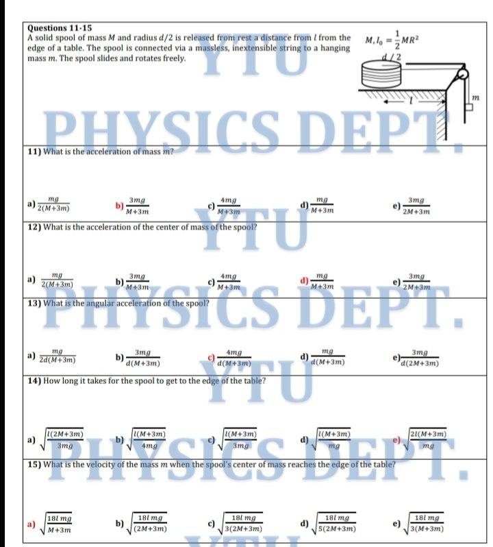

AL115
In the image.
In the image.
My attempt to solve the first one.
T-mg=ma
T=m(g+a)
TR = Iα
I=(1/2)(M)(R^2)
α=a/R
TR=(1/2)(M)(R^2)(a/R)
T=(1/2)Ma
mg+ma=1/2Ma
a=(2mg)/(M-2m)
And... I got a wrong answer. As usual.

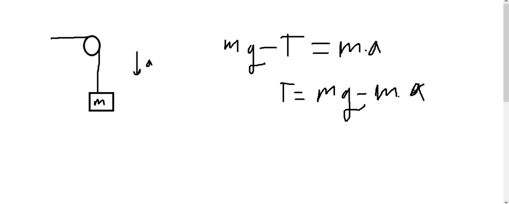

I just made a dumb mistake. Acm is not equal to 3a. a is equal to 3Acm. which means At is equal to (2/3)a
which means
mg+ma=(1/2)M(2/3)a --->a = 3mg/(M-3m)
which means I have a problem with the sign. So the equation should be T=mg-ma so that means that the mass is accelerating downward and not upward. right?

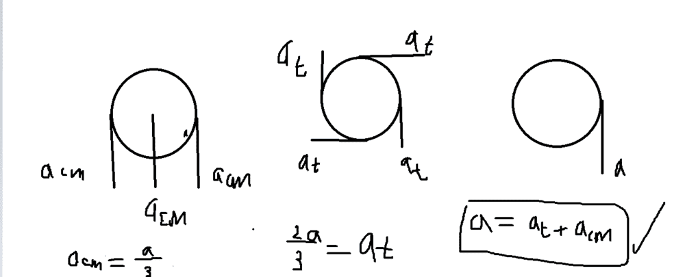

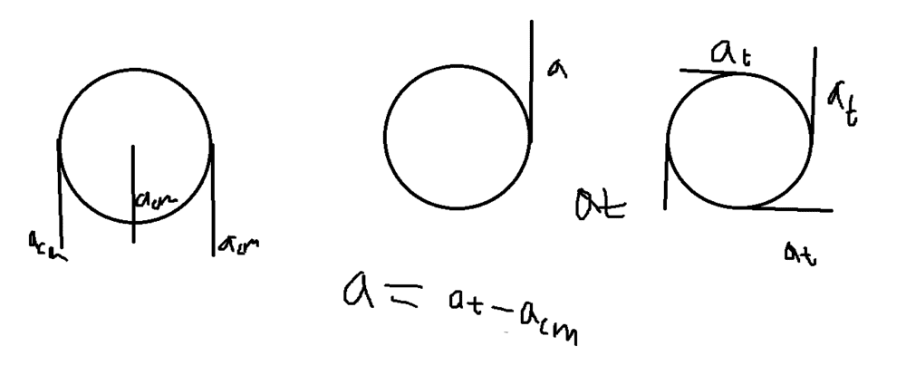

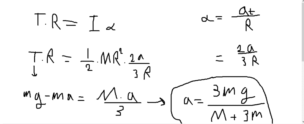

This is what I came up with.
I am not sure if this is how the problem should be solved. I also relied on the fact that At = 2Acm which I got from looking at the answers. Now I need to know why At = 2Acm.

Yes, the hanging mass will accelerate downwards, but as I wrote, it is perfectly fine to take up as positive. The sign error came in because of inconsistencies elsewhere.
With a as positive up for the hanging mass it must be positive to the left in the diagram for the spool.
With tension as positive up for the hanging mass it must be positive to the right on the spool.
Your diagrams imply you are taking anticlockwise (as viewed from above) as positive for the spool's rotation.
It remains to decide which way is positive for ac, the linear acceleration of the spool's centre. You choose, and state your choice.
With all that in place, post the equations you get for:
- the linear acceleration of the point where the string leaves the spool, relative to the spool's centre, in terms of the angular acceleration and radius
- that same linear acceleration, but now relative to the table
- the equation relating that last to a, the upward acceleration of the hanging mass
- the equation relating the tension to the angular acceleration
- the equation relating the tension to the linear acceleration ac
Please do not post working as images. Per forum guidelines, that is intended for diagrams and textbook extracts etc. Typing in your working makes it not only easier to read but also easier to refer to specific steps when commenting.

I chose the downward direction in the image (the direction of the acceleration of the center of mass) to be the negative direction.
-α R
-α R+ac
-α R=(2/3)a @bold wouldn't the hanging mass accelerate downward?
-T=(1/2)MRα
-T=MRac
are they correct? Also can you tell me why α R=2ac
AL115 said:
α R=(2/3)a
How do you get that?
My question was the relationship between α R+ac and a.
I got it from the answers in the first image.
Question 13- Answer C-
α =(4mg)/(d(M+3m))
R=d/2
α R=(2mg)/(M+3m)=(2/3)a
a = α R+ac
α R is the at in the last image.

I just realized that I made a dumb mistake (again) in the post #14. I wrote the equation relating the tension to the linear acceleration ac as T=MRac which is obviously wrong. It is T=Mac. And we also know that
T = (1/2)MRα = (1/2)Mat
We get that at=2ac. Now everything makes sense.
My problem was that I thought that there was some external forces. One causing the spool to rotate in anti-clockwise direction (thus pulling the sting which makes the mass accelerate upward). And another causing the linear motion.
But that's wrong. The force that is causing both the linear motion and the rotational motion in the spool was the tension force!
T=Mac.
T = (1/2)MRα
Thank you very very much for the help.
