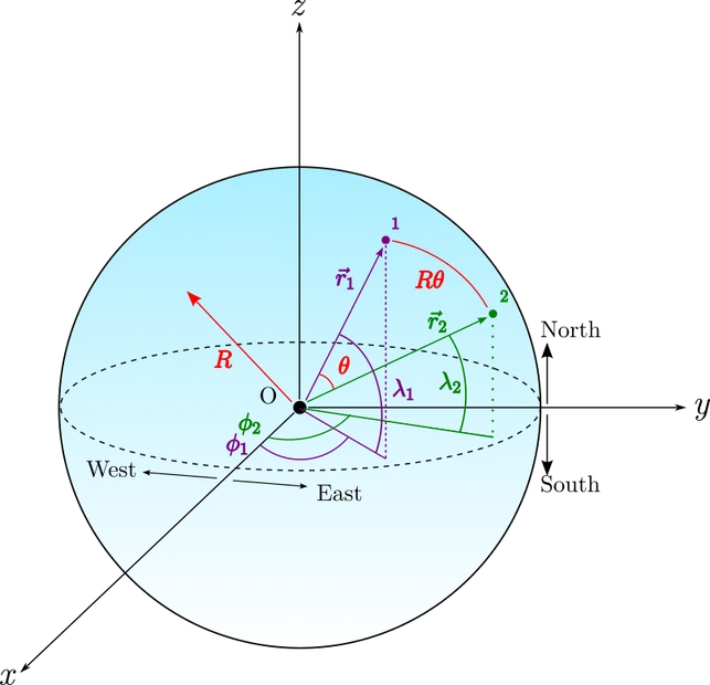

Let vectors from the center of the earth to two points on the surface be ##\vec{r}_1,\vec r_2##. If the angle between them is ##\theta##, find the expression for ##\theta## in terms of the co-ordinates of the two points, them being their latitudes ##\lambda_1,\lambda_2## and ##\phi_1,\phi_2##. (See sketch below)
1. A vector ##\vec a = a(\cos\alpha\hat i+\cos\beta\hat j+\cos\gamma\hat k)##, where the angles are well known. Here, ##\alpha = \phi## and ##\gamma = \pi/2-\lambda##.
2. If the direction cosines written in (1) above be given by the symbols ##l,m,n##, then ##\cos\theta=l_a l_b+m_a m_b+n_a n_b##.
3. We also have ##l^2+m^2+n^2=1## as the relation between the direction cosines for a vector.
Problem statement :
I copy and paste the problem as it appeared in the text. [Kleppner, D., Kolenkow, R. (2014). An Introduction to Mechanics. Cambridge University Press (2E)]. The statement itself is rather long-winded. The question to be answered appeared towards the end of the passage :
##\color{red}{\text{Find an expression for}\;\theta\;\text{in terms of the co-ordinates of the two points.}}##
By co-ordinates, I am assuming the latitudes and longtidues of the two points, ##[(\lambda_1,\lambda_2),(\phi_1,\phi_2)]##.
Attempt : I took the liberty to draw a better image which show the latitudes and longitudes of the two places.
The image shows places ##P_1## and ##P_2## drawn in purple and green and green, respectively, as well as their latitudes ##\lambda_i## and longitudes ##\phi_i## for ##i = 1,2##. The angle between their position vectors is ##\theta##, shown in red.
Cluttered though the symbols are, I hope they can be distinguished.
We know ##\cos\theta = l_1 l_2+m_1 m_2 + n_1 n_2\qquad (1).##
Here, ##l_i = \cos\phi_i##, ##n_i = \cos\gamma_i = \sin\lambda_i##, where ##\gamma## is the (well-known) angle that a vector makes with the ##z-##axis. The values ##m_i=\cos\beta_i##, the angle with the ##y-##axis. These can be calculated using ##l^2+m^2+n^2=1\Rightarrow m_i = \sqrt{1-\cos^2\phi_i-\sin^2\lambda_i}##, the index ##i## taking values 1 and 2 throughout.
We know, ##1-\cos^2\phi_i = \sin^2\phi_i##.
From ##(1)## above, all this yields ##\boxed{\cos\theta = \cos\phi_1 \cos\phi_2+\sqrt{\sin^2\phi_1-\sin^2\lambda_1}\sqrt{\sin^2\phi_2-\sin^2\lambda_2}+\sin\lambda_1 \sin\lambda_2}##.
I'd check the answer presently, but am I on the right track?
Many thanks.
I would rotate the sphere so that one point is at the north pole (0,0,1). Then ##\theta## is just the colatitude of the image of the second point.
I would write two unit vectors $$\mathbf{\hat r}_i=\cos\phi_i\cos\lambda_i~\mathbf{\hat x}+\sin\phi_i\cos\lambda_i~\mathbf{\hat y}+\sin\lambda_i~\mathbf{\hat z}~~~~(i=1,2)$$ then take their dot product.

brotherbobby said:
I'd like to know where's the mistake.
##\mathbf{\hat r}=\cos\phi\cos\lambda~\mathbf{\hat x}+\sin\phi\cos\lambda~\mathbf{\hat y}+\sin\lambda~\mathbf{\hat z}.##
The directional cosines are
##l=\mathbf{\hat r}\cdot \mathbf{\hat x}=\cos\lambda\cos\phi##
##m=\mathbf{\hat r}\cdot \mathbf{\hat y}=\cos\lambda\sin\phi##
##n=\mathbf{\hat r}\cdot \mathbf{\hat z}=\sin\lambda##
It follows that
##l^2+m^2+n^2=1\implies m^2=1-l^2-n^2=1-\cos^2\lambda\cos^2\phi-\sin^2\lambda##
Therefore,
## m_i=\sqrt{1-\cos^2\lambda_i\cos^2\phi_i-\sin^2\lambda_i}.##

Just to add…
##\sqrt{1-\cos^2\phi-\sin^2\lambda}## immediately smells wrong to me. And that may be because the argument of the square root could easily go negative. OTOH, ##\sqrt{1-\cos^2\phi\cos^2\lambda-\sin^2\lambda}= \sqrt{\cos^2\lambda-\cos^2\phi\cos^2\lambda}= \cos\lambda\sqrt{1-\cos^2\phi}=\cos\lambda\sin\phi##, which is guaranteed real.

Not sure here but are you assuming that latitude is a great circle?
What does that mean? The (blue) drawing in post #1 clearly defines the latitude angles of points 1 and 2 as ##\lambda_1## and ##\lambda_2.## Points 1 and 2 are shown joined by an arc on a great circle that, in general, is neither a circle of latitude nor a circle of longitude. That's all that's needed to process this problem.
