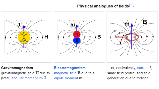

So one of the major topics in physics is trying to reconcile quantum mechanics and general relativity.
And the classical expression of electromagnetism is Maxwell's equations, and its linked to quantum models of electromagnetism.
And then there's also a gravitational analogue of Maxwell's equations, gravitoelectromagnetism (GEM), and it can function as a close approximation of GR within certain ranges of parameters.
So I was wondering about the attempts to apply existing quantum models through the Maxwellian parallel between EM and GEM at those certain ranges (where the approximation to GR is close) in order to shed more light on possible or potential quantum models of gravity.
What have been the results of such attempts?
