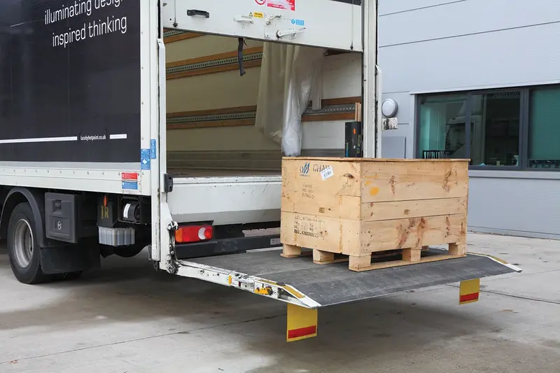

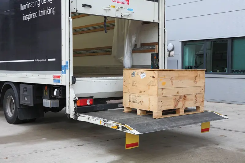

Does yours look like the one in the picture?
Rear of a white box truck with a tail lift platform lowered to ground level, carrying a wooden crate on a pallet.

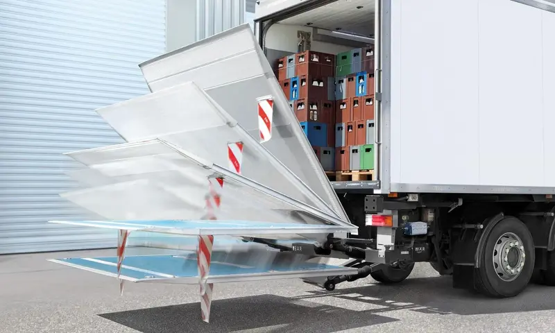

bwtom said:
The strange behavior only happens when lowering — instead of coming down smoothly, it moves in small jerks and sometimes pauses briefly before continuing. Lifting up still seems normal.
It sounds more like a mechanical restriction to me.
If so, the problem should be more evident when the platform is closer to being vertical and less when it is closer to being horizontal.
Tail lift on the rear of a white box truck, platform shown in several raised and lowered positions, with red and white hazard-striped markers and stacked crates visible inside the cargo area.
