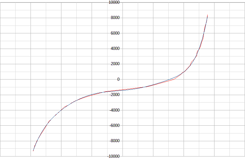

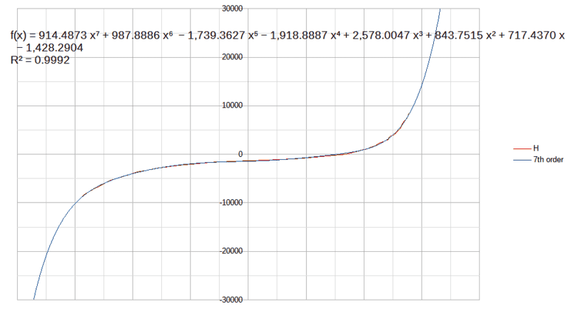

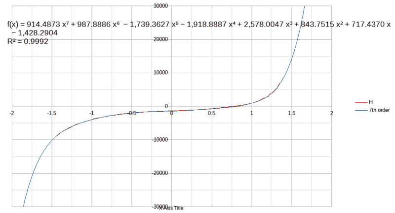

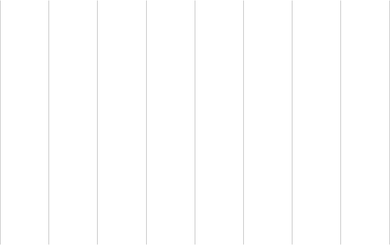

7th order Polynomial seems just fine with a fit of 0.9992 when you swap BH on the XY axis.
rounded off with H on the Y axis
Here I even extrapolated the trend.

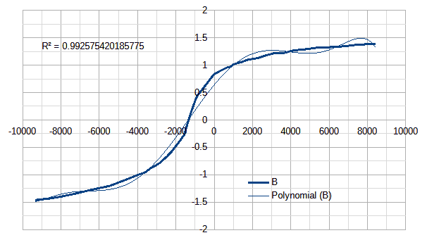

But due to what seems to be measurement error with B on the Y axis with amplified Nth order overshoot. I'm not saying the error was with B but this way errors are reduced.
You can recompute the data and see how much error existed with some of the measurements.
As you observed with B on the Y axis
I used scalc.exe from OpenOffice.

How do you get a polynomial to have zero slope when extrapolated to large inputs? like for a step function?
Above I showed how to reduce the error by inverting the function. Can you think of another function?
