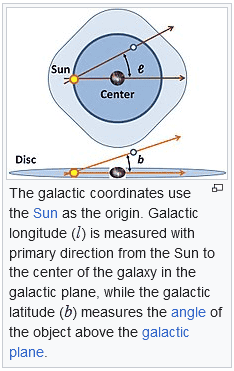

That seems weird to me. Why is our Sun designated as the origin of that coordinate system? Shouldn't it be the center of the Milky Way Galaxy instead? Does the Equatorial Coordinate System also use the Sun as the origin?
Diagram of galactic coordinates: a top-down view of the galaxy with the Sun at left, the galactic center marked, and angle l from the Sun to the center; below, a side view showing angle b above the galactic plane.
A Sun centred galaxy makes it easier to calculate what the sky will look like above our heads. To us, our galaxy appears to be Sun centred.
Also we know with pretty high precision where the sun is. The location of the center of the galaxy has very wide error bars (+- 0.8 kpc from Reid et al 2009, ApJ, 705, 1548) so it is pretty useless as the center for calculations.
The frame has been chosen for convenience. After all, none of us (including JWST) are more than a million miles from the origin.

We orbit the Sun regularly so using the Earth would make it inconvenient to use Earth as an origin - a conversion would be needed for every observation. Using the Sun as origin must be the least worst choice, particularly for distances that can be measured in Parsecs (I think).
