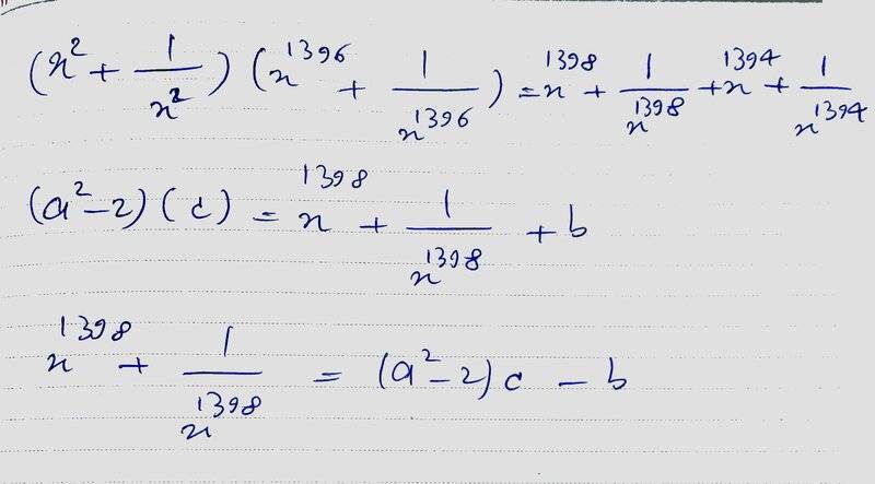

If ##x+1/x=a## and ##x^{1394}+\frac {1}{x^{1394}}=b## and ##x^{1396}+\frac {1}{x^{1396}}=c## then what is ##x^{1398}+\frac {1}{x^{1398}}## equal to?

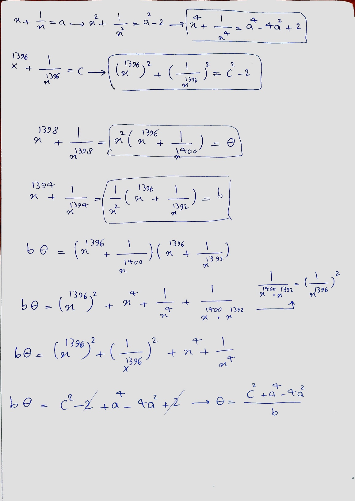

Hello. This is my answer:
https://up.maralhost.com/imagef-37f78ec7d1bd1-jpg.html
Can someone tell me If I am wrong?
Book's answer:
Handwritten algebra on lined paper: (x^2 + 1/x^2)(x^1396 + 1/x^1396) = x^1398 + 1/x^1398 + x^1394 + 1/x^1394; below, (a^2 - 2)(c) = x^1398 + 1/x^1398 + b; and x^1398 + 1/x^1398 = (a^2 - 2)c - b.
MatinSAR said:
Homework Statement: If ##x+1/x=a## and ##x^{1394}+\frac {1}{x^{1394}}=b## and ##x^{1396}+\frac {1}{x^{1396}}=c## then what is ##x^{1398}+\frac {1}{x^{1398}}## equal to?
Relevant Equations: Empty.
Book's answer:
The book answer appears simple and unimpeachable to me.
MatinSAR said:
Thanks for your reply.
You were not able to understand my answer(I am sorry it was not clear) or it was compeletly wrong?
More clear explanations and better quality:
That looks like an alternative. ##a,b,c## are related, so there must be several different identities hidden there.
Thank you again. For taking time to help me...
I will try to find a link between 2 answers. If it was successful I will inform...
Yes, it is a poor question. E.g. you could solve the quadratic to find x as a function of a then plug that in.
It should be structured as "show that".
