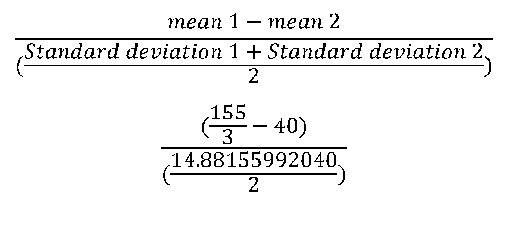

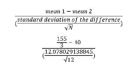

For the t-test I used the realted t-test, since its repeated measures (same participant in both):
I got t= 3.346118674
are the units sd?
and DoF would be 11, and since I specified a direction, I got p=0.003261139 (one-tailed); which is significant? since P is less than 0.05?
and for effect size:
I got (d)= 1.567935986
Can someone verify the t-test, effect size and p value for me? Please! I used fractions at some points where I could quickly get the data (I wrote it down), in ideal circumstances should I use fractions for all the 'inputs' (e.g. stand. dev of difference, etc.), if possible, since its more 'accurate'?
Thanks! I now it's a lot to ask, but I would geratly appreciate it! I realize the formuale are slightly different depending on the narue of the experiment, I think I chose the right ones!
It's been a while since I've done anything with statistics, but I think you might not be using the right form for t. The form I've included is for a two-sample t test, which seems to me the right one for your problem.
Instead of the standard error, I think you might need to use a pooled standard deviation.
[tex]t = \frac{X - Y}{S_p\sqrt{\frac{1}{12} + \frac{1}{12}}}[/tex]
where X and Y are the sample means for the two conditions, and [tex]S_p[/tex] is the pooled s.d., which is given as
[tex]\sqrt{\frac{(n - 1)s_x^2 + (m - 1)s_y^2}{n + m - 2}}[/tex]
For your problem, n = m = 12.
Your use of fractions and decimal values probably won't affect your values, since you apparently used quite a few decimal places in your calculations.
The t distribution is close to a normal distribution with mean 0 and s.d. 1. For n around 30 there's no difference between the two distributions. That should answer your question about units of s.d.s.
Hope this is helpful.
