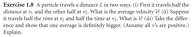

A particle travels a distance ##L## in two ways.
(i) First it travels ##\textbf{half the distance}## at ##v_1## and the other half at ##v_2##. What is the average velocity ##\bar v##?
(ii) Suppose it travels ##\textbf{half the time}## at ##v_1## and the other half of time at ##v_2##. What is ##\bar v##?
(iii) Take the difference and show that one average is definitely bigger. (Assume all v’s are positive.) Explain.
Average velocity ##\bar v=\dfrac{\text{Total displacement made}}{\text{Total time taken}}=\dfrac{\Delta x}{\Delta t}##.
Text of Exercise 1.8: A particle travels a distance L in two ways. (i) Half the distance at v1, half at v2; find average velocity. (ii) Half the time at v1, half at v2; find v. (iii) Show one average is bigger. Assume all v's positive. Explain.

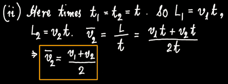

Handwritten solution on black background: L1 = L2 = L/2, t1 = L1/v1 = L/(2v1), t2 = L2/v2 = L/(2v2), average velocity v1 bar = L/(t1 + t2) = 2v1v2/(v1 + v2), boxed.
Handwritten derivation on black background: times t1 = t2 = t, so L1 = v1 t and L2 = v2 t; average velocity v2 bar = L/t = (v1 t + v2 t)/2t, boxed result v2 bar = (v1 + v2)/2.

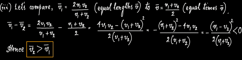

Handwritten derivation comparing two average velocities: v1 bar = 2v1v2/(v1+v2) versus v bar = (v1+v2)/2, concluding that v2 bar is greater than v1 bar.
My answers are right, but I could not explain (iii). Why must ##\bar{v_2}>\bar{v_1}\,?##

The averages can be equal if the speeds are equal. But, given the speeds ##v_1## and ##v_2## are different:
If you travel half the distance at a lower speed, then you travel at this speed for a longer time. This means that the time average is nearer the lower speed.

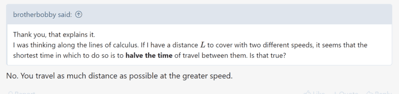

I was thinking along the lines of calculus. If I have a distance ##L## to cover with two different speeds, it seems that the shortest time in which to do so is to halve the time of travel between them. Is that true?
brotherbobby said:
Thank you, that explains it.
No. You travel as much distance as possible at the greater speed.

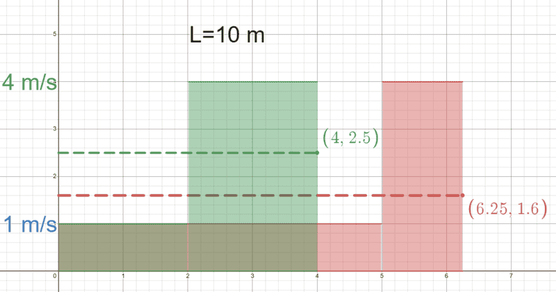

Here's a velocity-vs-time graph to visualize the calculation
and to support the interpretation by @PeroK .
Using nice numbers,
let ##L=10\rm\ m## and ##v_1=1\rm\ m/s## and ##v_2=4\rm\ m/s##.
In both cases, the total area under velocity-curve represents ##L##.
  • The red rectangles represent the motion for equal displacements at each velocity.
    So, the red-rectangles have equal area,
    with height equal to the velocity and thus width equal to the time-spent.
    The rectangle for the average-velocity also has an equal area (the total displacement ##L##),
    whose height (##v_{i,avg}##) is determined by the base (the total time-spent ##\Delta t_i##).
  • The green rectangles represent the motion for equal durations at each velocity.
    So, the green-rectangles have equal bases,
    with height equal to the velocity and thus area equal to the displacement traveled.
    whose height (##v_{ii,avg}##) is determined by the base (the total time-spent ##\Delta t_{ii}##).
Velocity-versus-time graph with L=10 m: a 1 m/s segment and a 4 m/s segment, with green and red rectangles showing equal-duration and equal-displacement motion and dashed average velocity lines at 2.5 and 1.6 m/s.

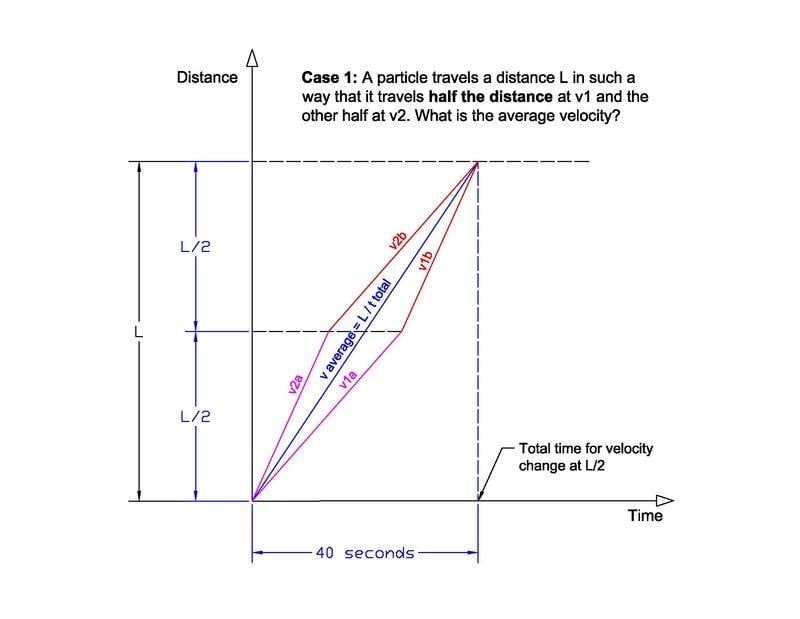

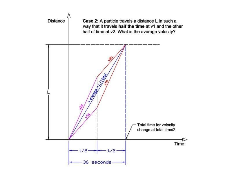

Distance against time graph with two piecewise-linear paths from the origin to the same endpoint, labelled v1a, v1b, v2a and v2b, with the straight average-velocity line marked L / t total; 40 seconds shown on the time axis.
Distance-time graph for Case 2: two piecewise paths from the origin to distance L, each with a midpoint kink at half the total time; labels v1a, v2a, v1b, v2b, a straight blue line marked v average = L / t total, and a 36 seconds span with t/2 intervals.

Note that ##\displaystyle v_{avg}\equiv\frac{\int v\ dt}{\int dt}##, which is generally not-equal to ##\frac{1}{2}(v_1+v_2)##. (See the calculation in the OP.)
In my opinion,
it is better to specify a slope on a position-vs-time diagram instead of an angle.
[The spacetime geometer in me is cringing at the sight of that angle.]

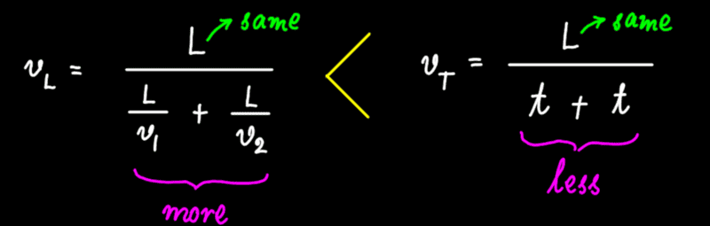

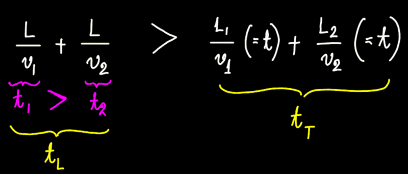

In this problem, since the total distance travelled remains the same, it is the times we should compare - I capture the point in the writings scibbled below.
Handwritten comparison on black background: v_L = L over (L/v1 + L/v2), marked more; less-than sign; v_T = L over (t + t), marked less. Green arrows label L as same.
Clearly, since we know the answer, if we call the first time of travel as ##t_L## and the second as ##t_T##, we have ##t_L>t_T##. But how is it so, conceptually?
We focus on the times.
Handwritten derivation in white on black: L/v1 + L/v2 with a greater-than sign, marked t1 and t2 in magenta, labelled tL; compared with L1/v1 (= t) + L2/v2 (= t) with a yellow brace labelled tT.
Handwritten white chalk-style inequality on black background: L1 (= v1 t) < L2 (= v2 t).
For the second case, equal times, we have ##L_1<L_2##.Hence, as per concept ##\boldsymbol C## above, when the object moves with equal times, it also covers a lower distance with the lower speed and therefore ends up taking less time on the whole.
But when it moves covering equal distances, the distance covered with the lower velocity is as much as that with the higher. Using concept ##\boldsymbol C## again, it does not change its distance accordingly, and ends up taking more time on the whole.
I believe this is the point that @PeroK made in post #2, assuming my reasoning is correct.

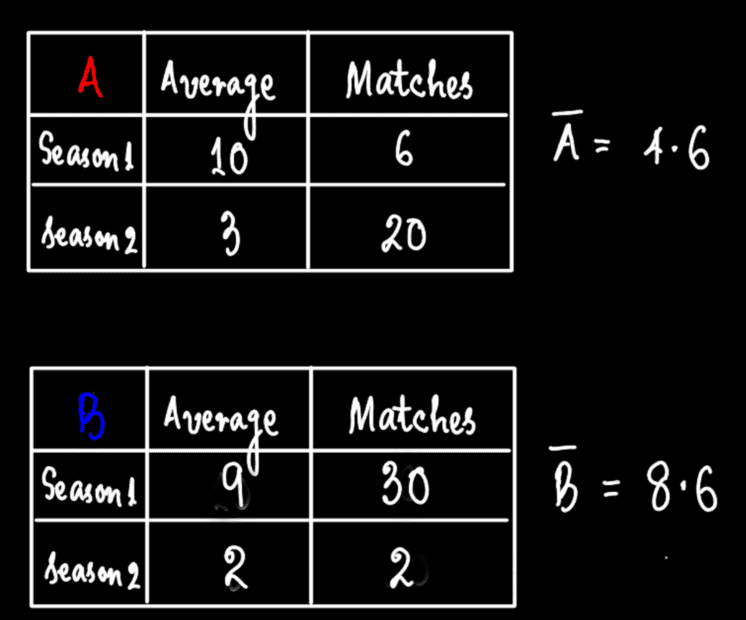

Here's an interesting related problem. Suppose we have two batters (could be cricket or baseball, depending on your taste). Suppose A has a better batting average than B in the first half of the season; and, a better batting average than B in the second half of the season. Prove that A must have a better batting average than B across the whole season.

Let A have a batting average of ##a## in the first season and ##b## the second season. Assume he has played ##m## matches the first season and ##n## the second season.
Let B have a batting average of ##c## in the first season and ##d## the second season. Assume he has played ##p## matches the first season and ##q## the second season.

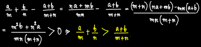

Subtracting the L.H.S. of the two equations (1) and (2) , I write out the following using ##\text{Autodesk Sketchbook}^{\circledR}##
Handwritten derivation on black background: a/m + b/n - (a+b)/(m+n) = (na+mb)/mn - (a+b)/(m+n) = [(m+n)(na+mb) - mn(a+b)] / [mn(m+n)] = (m^2 b + n^2 a)/[mn(m+n)] > 0 => a/m + b/n > (a+b)/(m+n).

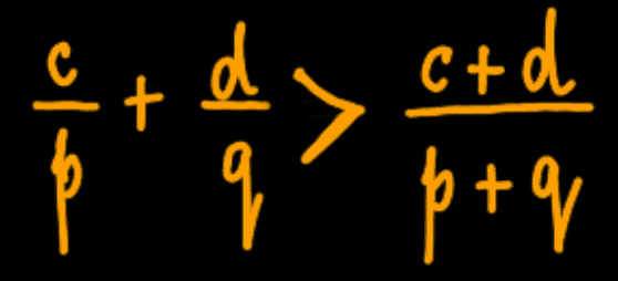

Handwritten inequality in orange on black: c/p + d/q > (c+d)/(p+q).
Likewise, we should have for the R.H.S. of the two equations (1) and (2) :
Let's call ##\dfrac{a}{m}+\dfrac{b}{n}>\dfrac{a+b}{m+n}\qquad (3)##
and ##\dfrac{c}{p}+\dfrac{d}{q}>\dfrac{c+d}{p+q}\qquad (4)##

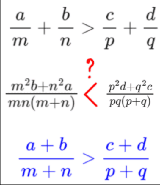

By how much are these greater? From the picture above, we have ##\frac{a}{m}+\frac{b}{n}-\frac{a+b}{m+n}=\frac{m^2b+n^2a}{mn(m+n)}##.
Likewise, ##\frac{c}{p}+\frac{d}{q}-\frac{c+d}{p+q}=\frac{p^2d+q^2c}{pq(p+q)}##
Handwritten-style math: a/m + b/n > c/p + d/q on top, a red question mark over a red less-than sign between (m^2 b + n^2 a)/(mn(m+n)) and (p^2 d + q^2 c)/(pq(p+q)), and blue (a+b)/(m+n) > (c+d)/(p+q) at the bottom.
These are the amounts we are "taking" away from the originals. If we can show that we are taking away less from the first expression than from the second, then we are done, given the original inequality. I put the reasoning to the right.

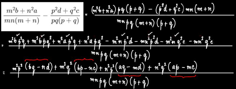

What is ##\dfrac{m^2b+n^2a}{mn(m+n)}-\dfrac{p^2d+q^2c}{pq(p+q)}?##
Handwritten algebra: the difference of two fractions, (m^2b + n^2a)/(mn(m+n)) minus (p^2d + q^2c)/(pq(p+q)), combined over a common denominator, with the expanded numerator and some terms underlined in red.
This is where am stuck. Is the last expression < 0?
Are the terms marked in red less than zero? The values ##a,\dots,d, m,\dots,q## are chosen arbitrarily with the only constraint : ##\dfrac{a}{m}+\dfrac{b}{n}>\dfrac{c}{p}+\dfrac{d}{q}##.
I don't see how the latter can be used to prove that the all those terms come out negative.
Request : I am open to any suggestion to solve this problem, which only appears easy intuitive. A thanks to @PeroK for suggesting it.

It's not true!
  • Wow
Or, for player A:
$$(1\times 50) + (9 \times 20) = 230/10$$Player B:
$$(9 \times 40) + (1\times 10)= 370/10$$
Handwritten chalkboard-style tables comparing players A and B over two seasons, with columns for Average and Matches; A has averages 10 and 3 with 6 and 20 matches, B has 9 and 2 with 30 and 2 matches, and overall averages A = 4.6 and B = 8.6.
I suppose the trick to make it work is to give B more games with the better average and A less games with the better average and vice versa.
