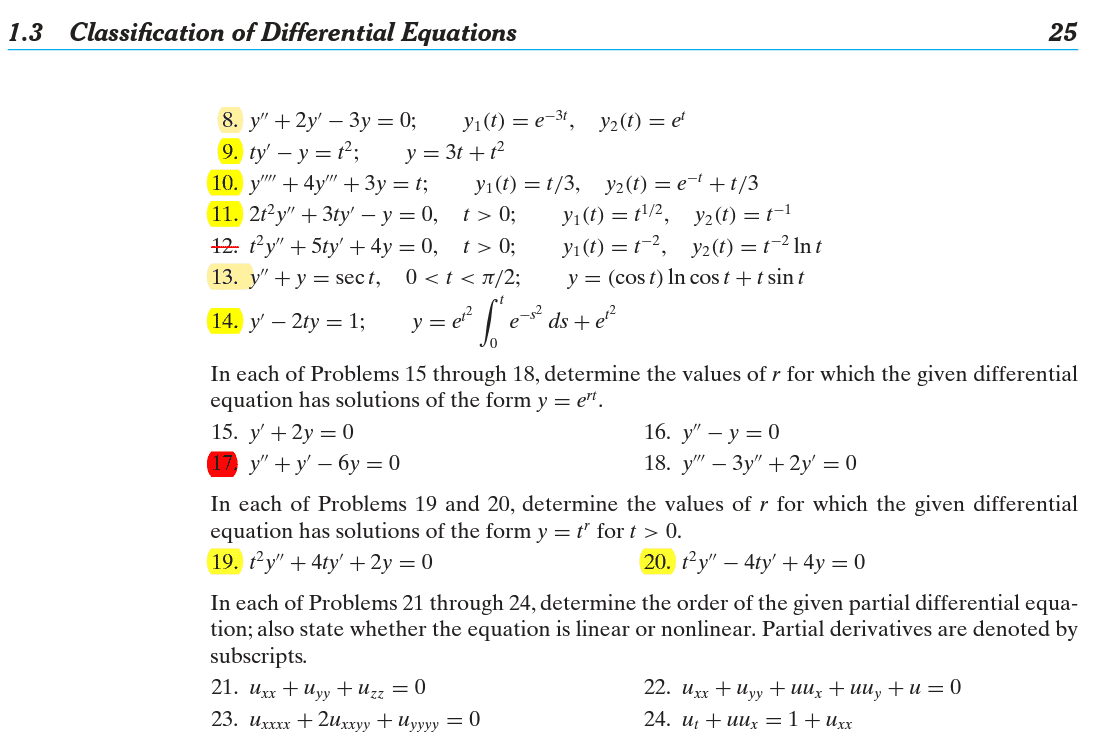

Find values of $r$ of the form $y = e^{rt}$
$y''+y'-6y=0$
$r^2+r-6=(r-2)(r+3)\quad \therefore r=2 \quad r=-3$
well so far
it that all there is to do?
However I didn't see clearly what the purpose of this was or how it is eventually used.
You are done.
The point is for y'' + y' - 6y = 0, subbing in [math]y = e^{rt}[/math] gives you both possible, thus all, solutions in this case. So a second order linear homogeneous differential equation with constant coefficients has a solution [math]y = Ae^{r_1t} + Be^{r_2t}[/math]. This can be extended in general to all orders.
-Dan
The problem specifically asked for a solution of the form $y= e^{rx}$.
Presumably you know that the derivative of $e^{rx}$ is $re^{rx}$ and that its second derivative is r times the derivative of $e^{rx}$ so is $r(re^{rx})= r^2e^{rx}$.
So taking y in $y''+ y'- 6y= 0$ to be $e^{rx}$ we get $r^2e^{rx}+ re^{rx}- 6e^{rx}= 0$. There is a "$e^{rx}$" in each term and $e^{rx}$ is never 0 so we can divide by it, eliminating x entirely, and leaving $r^2+ r- 6= (r+ 3)(r- 2)= 0$.
That is, $e^{rx}$ satisfies the differential equation if and only if r is either 2 or -3. Since this is a linear homogeneous equation, any linear combination, $Ae^{2x}+ Be^{-3x}$, where A and B can be any constants, is also a solution. Since, further, this is a second order linear homotenous equation, the set of all solutions forms a two dimensional vector space so every solution is of that form- $e^{2x}$ and $e^{-3x}$ form a basis for that vector space.
