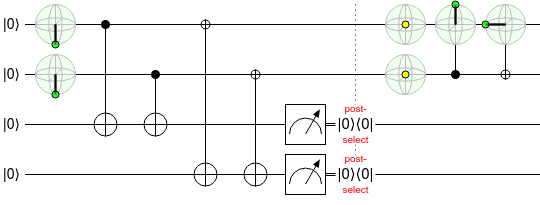

Measurement only destroys superpositions when all the measurement results correspond to states that aren't in superposition. If the measurement results correspond to states in superposition, measurement will create superpositions.
So you have it exactly backwards. Doing a Bell state measurement won't just keep a system in a Bell state, it will force the system into a Bell state
Here is an example circuit in Quirk which demonstrates this fact:
Screenshot from 2016-07-26 19:29:21.png
At the start, the two top qubits are Off. Then they are each conditionally NOT-ed into the two ancilla qubits at the bottom, using Z-axis and then X-axis controls. This copies the Z-parity and X-parity of the two top qubits into the bottom qubits, where they can be measured. This is a Bell basis measurement. Then the circuit focuses on the measurement result where both parities were Off (the same basic thing happens in the other three cases). Notice that the two top qubits are no longer Off. In fact they are now entangled into the state ##|00\rangle + |11\rangle##.

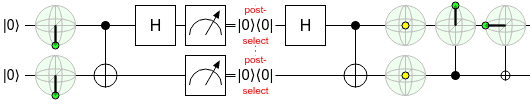

You can also perform the measurement inline by transforming out of of the Bell basis, performing a measurement, then transforming back into the Bell basis. This makes it very obvious that the output is in superposition. (It's so obvious that I felt like it didn't address your question, which is why I did the more complicated measurement using extra qubits instead.) Here's the inline circuit:
Screenshot from 2016-07-26 19:37:37.png
