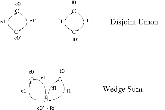

[size=+1]Wedges of Circles[/size]
Now consider three one dimensional spaces which are all homotopy equivalent to a wedge of two circles
  • two circles joined by an edge
    [tex] \partial_1 = <br /> \left[ \begin{array}{rrr|l}<br /> e_1 & e^\prime_1 & e^{\prime\prime}_1 \\<br /> \hline<br /> 1 & 0 & 0 & e_0 \\<br /> -1 & 0 & 0 & e^\prime_0<br /> \end{array} \right][/tex]
  • two circles joined at a common point
    [tex] \partial_1 = <br /> \left[ \begin{array}{rr|l}<br /> e_1 & e^\prime_1 \\<br /> \hline<br /> 0 & 0 & e_0 <br /> \end{array} \right][/tex]
  • a circle spanned by an edge
    [tex] \partial_1 = <br /> \left[ \begin{array}{rrr|l}<br /> e_1 & e^\prime_1 & e^{\prime\prime}_1 \\<br /> \hline<br /> 1 & 1 & 1 & e_0 \\<br /> -1 & -1 & -1 & e^\prime_0<br /> \end{array} \right][/tex]
We can use the indicated boundary maps. These examples are not homeomorphic to each other, but they are homotopy equivalent to each other, so they have identical homology. This shows that homology is certainly not a complete invariant for classification up to homeomorphism.

Given [itex]C(X), \; C(Y)[/itex] we can find a chain complex for a wedge sum by slightly modifying [itex]C(X) \oplus C(Y)[/itex]. We'll have one less zero-cell (since we will identify two zero-cells of the disjoint union) and we'll need to modify the matrix representing the boundary map [itex]\partial_1[/itex].
Example one: compute the wedge sum of two circles [itex]S^1 \vee S^1[/itex]. (A circle is topologically homogeneous, so it shouldn't matter which pair of points we choose to identify, hence "the" wedge sum).
First, recall that if we think of a circle as made from two zero cells and two one cells, then the boundary map [itex]\partial_1[/itex] can be written
[tex] \left[ \begin{array}{rr|l} <br /> e_1 & {e^\prime}_1 & \\<br /> \hline <br /> 1 & -1 & e_0 \\<br /> -1 & 1 & {e^\prime}_0<br /> \end{array} \right][/tex]
where the matrix equation
[tex] \left[ \begin{array}{r} 1 \\ -1 \end{array} \right] =<br /> \left[ \begin{array}{rr} 1 & -1 \\ -1 & 1 \end{array} \right] \;<br /> \left[ \begin{array}{r} 1 \\ 0 \end{array} \right][/tex]
means that [itex]\partial_1 e_1 = e_0 - {e^\prime}_0[/itex], and likewise, [itex]\partial_1 {e^\prime}_1 = {e^\prime}_0 - e_0[/itex]. (I have uploaded a figure which should appear at the bottom of this post, explaining the labeling of the cells in this example.)

This shows we must do in general to modify the matrix representing the boundary map [itex]\partial_1[/itex]: if we will identify zero-cells i,j, then we must
  • delete row i
  • add this to row j
We can do this using Macaulay2 by first creating a matrix which encodes those two operations, and then premultiplying the boundary map for the disjoint union, to obtain the boundary map for the wedge sum. If we need to modify a matrix with seven rows (indexed 0 to 6 in Macaulay2), deleting row 1 and adding that to row 3, we should premultiply by this matrix

In our example, the disjoint union [itex]S^1 \amalg S^1[/itex] has chain complex
Code:
i187 : S1 = matrix{{1,-1},{-1,1}}
o187 = | 1  -1 |
       | -1 1  |
                2        2
o187 : Matrix ZZ  <--- ZZ
i188 : chainComplex(S1++S1)
         4       4
o188 = ZZ  <-- ZZ
       0       1
o188 : ChainComplex
i189 : prune HH oo
o189 = 0 : ZZ
       1 : ZZ
o189 : GradedModule
where the last shows the homology (note that two path components are visible in dimension zero), while the chain complex of the wedge sum [itex]S^1 \vee S^1[/itex] is given by
