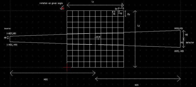

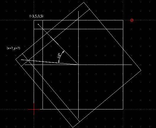

Hello I'm a student engineer and I'm trying to find the weighted reconstruction matrix used for ART image reconstruction. The weighted matrix gives for each projections what pixels are influenced by a ray from a laser.
In attachment you see an image of what the problem is. The matrix must be rotated a given time for a given rotationangle each time. For this example it is 40 degrees and 8 times. I must calculate whenever a cell falls into the ray and give that cell a one. The cells outside the ray get a zero. So for every rotation i have to calculate which cells fall in the ray. I have the begin coordinates, and tried so to find out the next. But i don't what i do wrong, tried with poolcoordinates but i can't find it.
My second problem is with the detection, The ray is lineair but how can I calculate when the cell is in the ray. If its a rectangle its simple, but i can't find it when its oblique.
The coordinates are given and the all the distances in the second attachment. I really hope someone can help me.
Here the MATLAB code i already have:

  • Diagram of a square grid of cells with a laser ray drawn as a thin line from the left at about 40 degrees, with rotated copies of the grid outlined; labels show (-3.5,3.5) and (x=?, y=?).

  • Technical diagram of a fan-beam ray geometry: a grid of square cells with labelled dimensions Lx, Ly, Dx, Dy, dx, dy, a source on the left and detector on the right, with ray half-width HR and HD, and distances HDS.

I don't use Matlab enough to evaluate your code. The way to compute the coordinates of a point in 2D when coordinates are rotated about a given point for a given angle is well known. Do you need to know that formula?
The "ray" looks like a quadrilateral. There are several ways to find if a square is totally within, totally without or partly-in and partly-out of a quadrilateral. Is that what you're asking? Or do you need to compute the area of overlap between the square (the grid cell and the quadrilateral?
Hey thanks for your return. Finally someone who can help me :)
Yes indeed i need the formules to compute the coordinates of a point in a 2D when the coordinates are rotated round a given point (0,0) for a given angle.
And the ray is indeed quadritlateral, the goal is to compute when a square ( given with the coordinates) is for a part in the quadritlateral.
Better would be the total area of the overlap between the square and the ray. So when a square is totally in the quadrilateral (ray) it gets a 1 and for a half 0.5 and so on... but i can't find it for a part so i totally don't know how to do that.
I would really be very gracefull if you could help me with this!
To rotate [itex](x,y)[/itex] about the point [tex](cx,cy) [/itex] counter clockwise by angle [itex]\theta[/itex][/tex][itex]:<br /> <br /> Transform [itex](x,y)[/itex] to a coordinate systems whose origin is [itex](cx,cy)[/itex]:<br /> <br /> [tex]x_1 = (x - cx)[/tex]<br /> [tex]y_1 = (y - cy)[/tex]<br /> <br /> Then rotate [tex](x_1,y_1)[/tex][/itex][tex]by angle [itex]\theta[/itex] about the origin:<br /> <br /> [tex]x2 = x_1 cos(\theta) - y_1 sin(\theta)[/tex]<br /> [tex]y2 = x_1 sin(\theta) + y_1 cos(\theta)[/tex]Then transform [itex](x_2,y_2)[/itex] back to a coordinate system with the original origin:<br /> <br /> [tex]x_3 = x_2 + cx[/tex]<br /> [tex]y_3 = y_2 + cy[/tex]<br /> <br /> I'll have to think about the intersection a square with a quadrilateral. In the meantime, you can find many web pages that explain how to find if a vertex is in the quadrilateral by searching for "point in polygon algorithm".[/tex]
