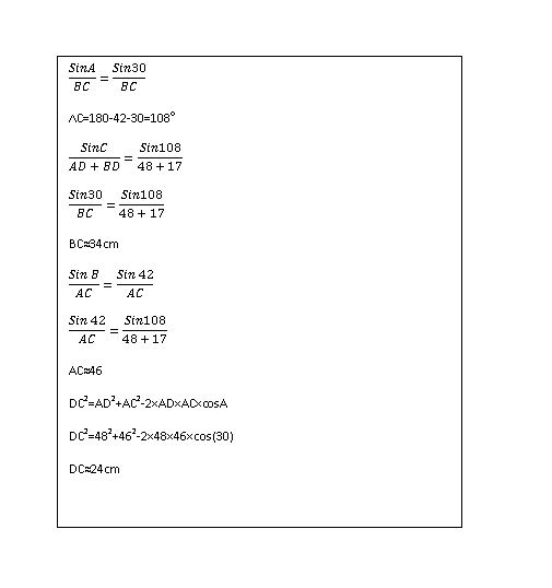

VitaminK
46
AD=48cm
BD=17cm
Calculate DC
Sine formula and cosine formula
Was just wondering if someone could take a look at my calculations and see if I've done them correctly.
VitaminK said:
Homework Statement:: AD=48cm
BD=17cm
Calculate DC
Relevant Equations:: Sine formula and cosine formula
That looks fine.
Of course, you could have found length DC using BC, BD, and angle C (the 42° angle). Maybe, use this as a check.

thanks!
