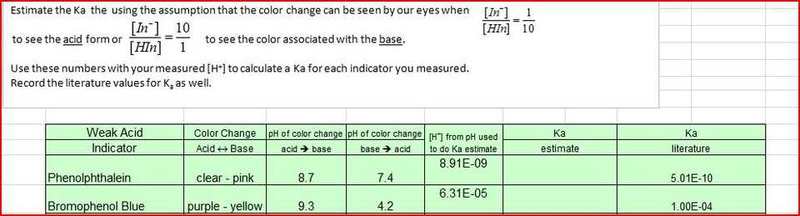

magma_saber
73
Estimate the Ka the using the assumption that the color change can be seen by our eyes when [ln-]/[Hln] = 1/10
to see the acid form or [ln-]/[Hln] = 10/1 to see the color associated with the base.
Use these numbers with your measured [H+] to calculate a Ka for each indicator you measured.
acid-base base-acid H+
Phenolphthalein 8.7 7.4 8.91E-09
I got the hydronium concentration by taking taking the average of the ph values and doing 10^-ph. How do i get the ka estimates?
Do i set up the equation like this: ka = 1/[H+] or something like this?
Describe the experiment that you did. I am almost sure you have not posted all information that you have.
ya i know that the phs are wrong. The bromophenol blue was really off. When calculating the H+ concentration, i only used 4.2, not 9.3.
