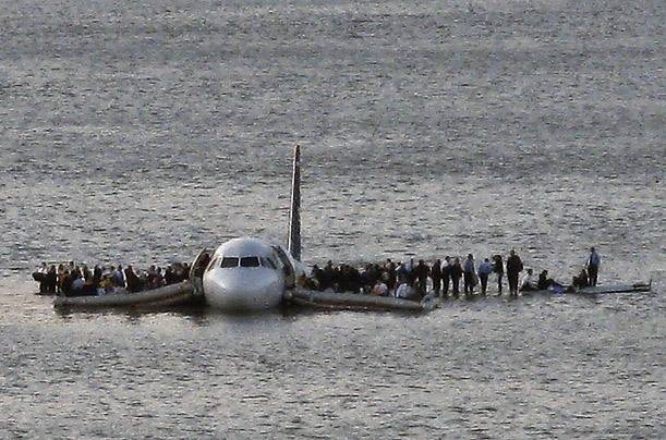

There have been instances of large planes making water landings "successfully", though:
http://en.wikipedia.org/wiki/US_Airways_Flight_1549
This might suggest the "perfect angle" is close to zero.

lisab said:
I'm not an aerospace engineer, but I think phinds is right.
There have been instances of large planes making water landings "successfully", though: This might suggest the "perfect angle" is close to zero.
Yes, and I think you realize it fully, but just want to be clear that that does NOT define a "perfect angle" in response to his question, which has the plane becoming a submarine, but rather answers the question "what's the best angle to hit the water and FLOAT and not break up?".
The answer to his question as asked is, there is no such angle.

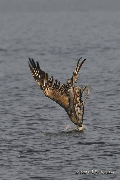

Ever watch pelicans dive for fish?
They fold their wings in and way back from flying position, and their long long beak breaks the water.
(photo courtesy of http://jerryjourdan.blogspot.com/2009/11/sanibel-island-fl-21-nov-2009.html)
and a pelican's stall speed is maybe a tenth of a jetliner's .

Yes, with a very short history of Gulf shrimping that is a very common sight, also I have watched a hawk take the same path from about 500' into a field of grass and weeds, then fly out with a snake in his claws. I would love to see how he checked his descent at those last few feet ??
What are you indicating in relation to the jet plane ?
Same things you said in #12:
Pelican enters with his fuselage perpendicular
but is able to streamline his wings so they aren't snapped off.
