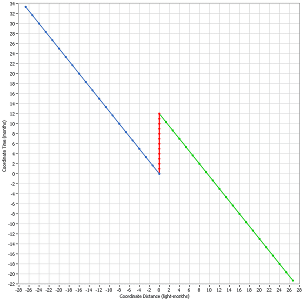

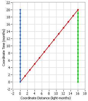

Here is a spacetime diagram to illustrate your scenario. It conforms to the numbers you provided in your OP and the numbers that The Duck provided for you in his post #2 except that I'm using months instead of years. Peter on the Earth is depicted in blue and the planet is green. The diagram is for the common earth-planet rest frame. Paul is depicted in red. The dots represent the passage of months for each observer/object:
Now here is the same scenario transformed to Paul's rest frame:
Note that the time on Peter's clock when Paul arrives at the planet is 7.2 months (0.6 years times 12 months/year) just as The Duck pointed out.
In a later post, you asked about Length Contraction. Yes, the distance between the Earth and the planet in Paul's rest frame is contracted from 16 light-months (1.33 light-years times 12) by the factor of 0.6 which comes out to be 9.6 light months. Can you see this at the Coordinate Time of 0?

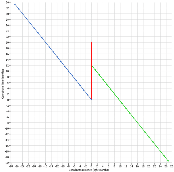

Here is a spacetime diagram showing Paul continuing past the planet:
Now you can see that everything (except the planet which we can ignore) is symmetrical between Peter and Paul. Just like in Peter's frame, when Paul's clock read 12 months (counting the red dots), Peter's clock read 20 months and we see that in Paul's frame, when Peter's clock read 12 months (counting the blue dots), Paul's clock read 20 months.
Does that answer your concern in this thread?

Thats great, I think I may have been mistakenly contracting the length between planets in Peters reference frame. These graphs are great I'm going to look for some graph drawing software,
