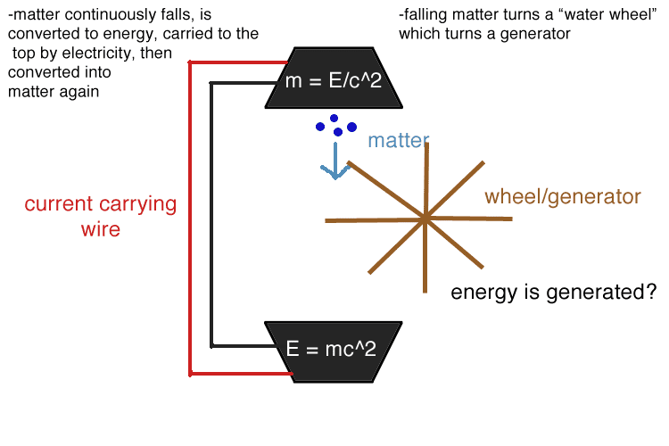

This is kind of similar to those troll science threads, but what am I missing here?
What if those energy-to-mass and mass-to-energy converters can reach 99.999% efficiency when converting to electricity to mass and vice versa in the future? Those converters are theoretically possible, aren't they?
Note, this is obviously an oversimplified diagram. The wires are simply meant to represent the transfer of energy from one area to another, in this case, from an area of lower gravitational potential to an area of higher gravitational potential.
The increased matter from restoring the substance to it's original potential is only relativistic. There is nothing new here and no acute efficiency over something such as a water wheel.

It will work but energy will be lost to heat.
You can increase the relativistic mass of an object by "carrying" it to a higher potential, therefor converting energy to mass though it is only relativistic and reference frame dependent.
The equation E = mc^2 is a relativistic equation.

Due to losses the amount of energy generated would be less and less each time. Over time the amount of matter produced at the top is less and less until you have none. You would be turning the matter into energy, just like any fuel sorce does. This is all assuming you even have a device that can efficiently create and destroy matter.

It is obviously very difficult for us to create and destroy matter right now. But let's say in 500 years we have something that can get extremely high efficiency. I don't see any reason why this would be impossible. I don't see any proof that there is a natural "cap" to the efficiency of these conversions.
The wheel could theoretically make up for the energy lost on a machine with something even as low as 80% efficiency. Let's say the top part (energy-to-matter) was 20 miles above the ground part (matter-to-energy). They could be connected by superconducting wire. There could, again theoretically, be hundreds of these water-wheels more than making up for the 80% efficiency.

ANY work you got out of the device would reduce the amount of matter (and energy) that you had. This is because work requires energy. The whole process would be 1000 times simpler if you just took out all the other stuff and left in the matter to energy converter.

Those converters are just meant to be obscure objects. The fact that the matter is slowed should have little to no effect.
I think the scenario is (assuming 100% efficiency for the sake of the argument):
You have an object on top, you let it fall on a sort of "waterwheel" except it isn't using water but rather it gets it's energy from the collision of the falling object. When the object is at the bottom, to raise it back up you would need as much energy as you got out of the falling object assuming 100% efficiency. But if you convert the object into energy and transfer it to the top using electricity or gears or something else and then convert it back into the object, would you lose any energy by transferring it like that assuming 100% efficiency? And if you would keep on repeating the process, would this sort of a machine be able to do work without requiring extra energy being inputted?
No, you would lose energy by transferring it against gravity.

Part of the kinetic energy is used by the "waterwheel", resulting in less energy gained at the matter-energy machine compared to what was released at the top. Repeated steps would cause the amount of matter dropped to dwindle until none was left.
IE: 100 protons are dropped from the top. They hit the wheel, cause work, and then fall to the bottom. The bottom device converts them to electrical energy and sends them to the topl. But wait! There isn't enough energy to send all 100 back to the top! So the device uses the energy of 1 proton to send the other 99. The process repeats and now only 98 can be sent to the top. After about 100 steps, there are no more protons! (By sending them to the top, I mean that it transfers enough energy to form 99 protons. Not that they are actually being transported)

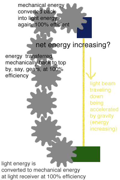

Hey, nice idea - here's another one. Say you shoot a gamma ray (energy) straight up, it hits your top converter and is converted into an electron and a positron (mass). The mass (electron/positron) now falls through the wheel and does some work, gets to the lower converter, the electron/positron join together and shoot straight up as a gamma ray again completing the cycle.
Where do we make up the energy? All I can think of is maybe we would loose energy to frequency shift as the lower converter is in a higher gravitational field.
No idea if this is correct...

Transferring it either horizontally or vertically makes no net difference. Vertically you have a gain in energy due to the matter falling that is counteracted by moving the energy, in whatever format, against gravity. Horizontally you have neither a gain nor a loss due to gravity.
The key here is that at BEST you could remove the water wheel and have a perfectly good perpetual motion machine. However, if you want to get work out of it then you WILL lose energy.
The gamma ray would redshift slightly on the way up, reducing its energy when it is absorbed by the machine on top. The loss in energy would be equal to the gain in kinetic energy of the falling particles.
If we remove the wheel, the matter will gain kinetic energy while falling, and this kinetic energy will be converted to heat when it hits the floor, bleeding the potential energy away.
(Or we could try to pick it up as well in the mass-energy-converter, maintaining a perpetuum mobile).
We are assuming a device to capture the matter and convert it into energy. The kinetic energy adds to the total energy, but that is counteracted by anything traveling against gravity back to the top.
