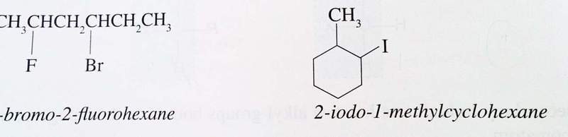

for the substance on the left of first photo, can I name it as 3-bromo-5fluorohexane? for the substance on the right can I name it as 2-iodo-1methylcyclohexane?
  • Two structures: left, a skeletal chain CH3CHCH2CHCH2CH3 with F below the second carbon and Br below the fourth, labelled 3-bromo-2-fluorohexane; right, a cyclohexane ring with CH3 on the top carbon and I on the adjacent carbon, labelled 2-iodo-1-methylcyclohexane.
No. You should choose numbers so that they are lowest possible.
I am not sure about the other one. I think numbering them 1, 2 is preferred over 2, 1 - it is the same rule as above, 1, 2 is considered the lower of two series.
