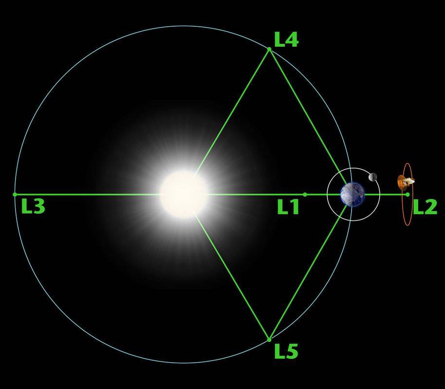

What you could do is put a sat at the Lagrange point L2.
They would be relatively stable there, with just the occasional adjustment.

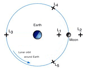

That is the sun-earth l2 in the picture. Here is earth-luna:
Thanks. I was looking for that.
But note, that will have the satellites seeing the same same of the Moon perpetually, something that (I think) is undesirable in the OP's opinion.

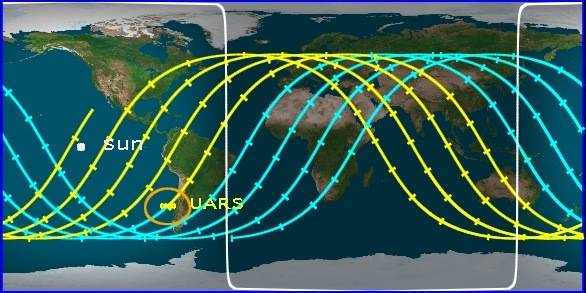

The hope is to use very small satellites with weaker sensors to save on cost and launch weight, then make up for that by placing them in an extremely low orbit (hoping for 20km). Apollo missions orbited between 60-70mi from the moon during their time. But from what I am reading, large mass concentrations on the planet cause any satellite below 100mi to suffer rapid orbit decay and crash. Then NASA discovered four orbital inclinations that a satellite could be into avoid the mass concentrations and stay in low orbit indefinitely regardless of the altitude.
Where my research is hitting a snag though is that the orbital inclinations don't tell me if they were chosen to keep the satellites constantly over the same ground so that they never near the mass concentrations, or were they chosen because that path caused the problems to cancel out. This conclusion is compounded by the moons extremely slow spin and tilt of only 1.5°.
What I want is an orbital path like below, but I can't seem to find research to see if it is possible.
This cannot be the reason since it can't happen.
1] Any orbital inclination other than 0 degrees will have the satellite making northward/southward passes.
2] Any orbit less than (or greater than) 88,000km in radius will have the satellite advancing westward/eastward.
*see caveat in sig line
IIRC, those 'frozen' orbits are still only meta-stable, subject to longer-term perturbation.
The axis of the orbit will have a fixed direction (pointing at some distant star). The Moon rotates about once a month, so you will get an orbital path similar to your image. The low orbit period is ~2hrs so successive passes will be about 1 degree apart.

Sam Phillips said:
What I want is an orbital path like below.
If you did, then orbital drift will inevitably take you over the mascons and your orbit would decay. Same goes for the highly inclined orbits recommended by NASA which DaveC and Keith_McClary pointed out will also drift. These orbits were never intended for extended periods of time; they'd need corrections to help stabilize them, and they were chosen to avoid the mascons. If you were stuck in an orbit over the same patch of the lunar surface, you could still possibly observe more of the Moon depending on your instrument's field of view.
