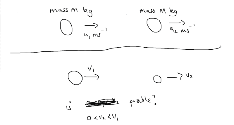

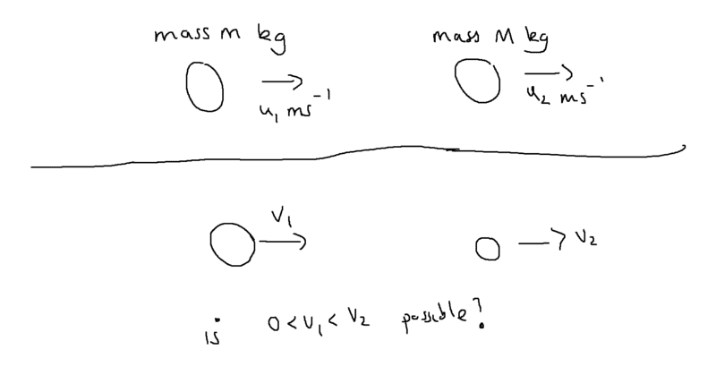

I wrote 0<v1<v2 as I know that in general v1<v2 is possible for all the trivial cases where v1<0. Hope this clears stuff up. Clearly u1>u2 etc.
Handwritten sketch of two colliding balls: mass m kg moving at u1 m/s and mass M kg moving at u2 m/s, below which balls move with velocities v1 and v2, with the question 'is v2 < v1 possible?' and the inequality 0 < v2 < v1.
  • Handwritten sketch of two particles before and after a collision: masses m kg and M kg moving right at speeds u1 and u2 m s^-1, then after collision speeds v1 and v2, with the question 0 < v1 < v2 possible?

I see. The issue I have now is that, when I am calculating the coefficient of restitution, I would usually write v2 - v1 for the separation velocity this works if v1 is positive or negative, but only providing that v2 is greater than v1, if its the other way around then clearly I am missing a negative sign.
I don't know what you are trying to do. Note that velocity is dependent on the reference frame. We can analyse any collision in the centre of momentum frame, where the objects rebound with equal and opposite momenta. Then, we simply switch to a frame where both objects are moving in the same direction after the collision. That's your required end-state solution. The initial state that produced it can be calculated by transforming the initial velocities to that reference frame.

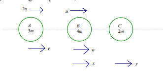

I will try explain it better. If after the collision v1 = 1 and v2 = 4 then clearly the separation speed is 3, and in the case of v1 = -1 and v2=4, the separation speed is 4 - (-1) = 5. In both cases its v2 -v1, as we know that v2 > v1 so this works. If the opposite is true, i,e that v1 >v2, say v1 = 3 and v2 = 1 then the separation speed is 3-1=2 not 1-3= -2. When I am given a problem with unknown velocities, and I write down e = v2 -v1/ approach speed, then clearly I will get the wrong answer if v1>v2 (I assumed v2 - v1 >0, iff v2 > v1).
Diagram of three circles A, B and C in a line, labelled 3m, 4m and 2m, with A moving right at 2u and B moving right at u, and below them arrows labelled v, w, x and y showing post-collision velocities.

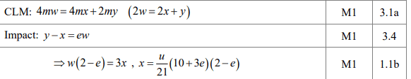

Here A and B collide with velocities 2u and u, resulting in velocities v and w, then B and C go on to collide. What I mean by "wrong sign" is that if we assumed (wrongly) that x > y then we would write e = (x-y) / w and that 4mw = 4mx + 2my, resulting in the wrong solution for x and y (in terms of w, e etc). The correct system of equations is y -x / w = e and 4mw = 4mx + 2my. How are we meant to know that y>x (its intuitive but there must be a genuine proof somwhere).
Three-row table of working for a collision problem: momentum equation 4mw = 4mx + 2my (2w = 2x + y), impact equation y - x = ew, and w(2 - e) = 3x with x = u/21 (10 + 3e)(2 - e), each tagged M1 with codes 3.1a, 3.4 and 1.1b.
##y > x## (strange symbols to use for velocities!) is a constraint of the system. The constraint is that the first object collides with the second one and cannot pass through it. ##x > y## is mathematically possible. There is the case where the first object misses the second one and there is no collision. That is a (mathematical) solution in all collision problems.
Thank you so much PeroK. I had a feeling it was a "physics" issue rather than a maths one.
