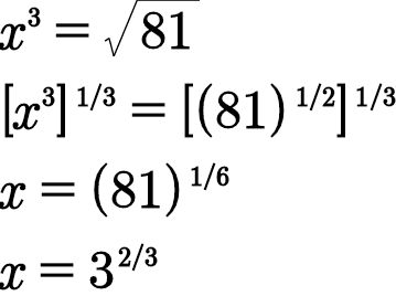

Is the following correct?
yes
You're actually missing two roots of the equation:
$$x^3=\sqrt{81}$$
Write as difference of cubes:
$$x^3-\left(3^{\frac{2}{3}}\right)^3=0$$
Factor:
$$\left(x-3^{\frac{2}{3}}\right)\left(x^2+3^{\frac{2}{3}}x+3^{\frac{4}{3}}\right)=0$$
The quadratic factor will yield the two complex conjugate roots. ;)

What do you think of MathMagic Lite? Cool, right?
1. Are you saying that my answer is wrong?
2. How badly was your area hit by Irma?
I much prefer $\LaTeX$...it looks a lot better, can be quoted, and seen in the "Topic Review" element. You can fix the last issue by attaching the images inline, but $\LaTeX$ is still the far superior solution for posting math expressions, IMHO. :)
No, I'm just saying there are two other values of $x$ that satisfy the given equation. Now, the answer you gave is real, and the other two solutions are complex, so unless the problem states only to look for real solutions, then we must give all 3.
