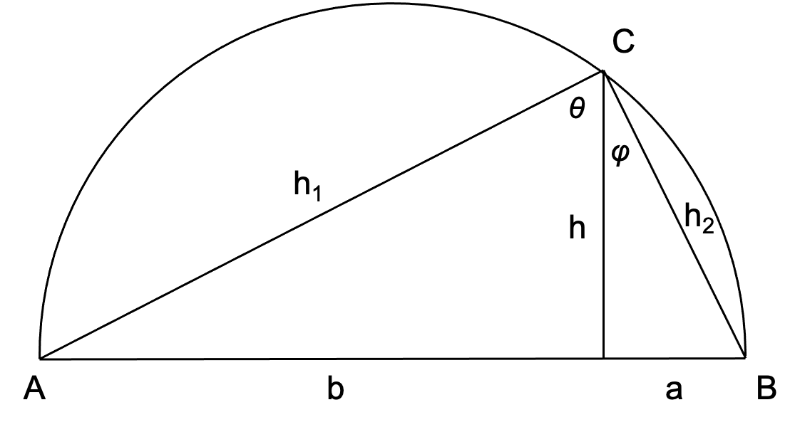

Here is an exercise for fun. It is a variation of a problem first worked out by Descartes. It is to show the length of the vertical segment is the square root of the product of the lengths of the horizontal segments.
In the figure below of a semi-circle, show that ##h=\sqrt{ab}##.
In the special case where ##a=1## unit length, then ##h=\sqrt{b}##. A complete discussion can be found in chapter 2 of the book An Imaginary Tale by Paul J. Nahin.
Mathematics news on Phys.org
##r^{2}=h^{2}+\left(r-a\right)^{2}\Rightarrow h^{2}=2ar-a^{2}=a\left(2r-a\right)=ab\Rightarrow h=\sqrt{ab}\quad\blacksquare##
Trigonometric proof
##\theta +\varphi=90^{\circ}##
Therefore
##\tan\theta=\cot\varphi\implies \tan\theta \tan\varphi=1.##
##1=\dfrac{b}{h}\cdot \dfrac{a}{h}\implies h^2=ab\implies h=\sqrt{ab}.##

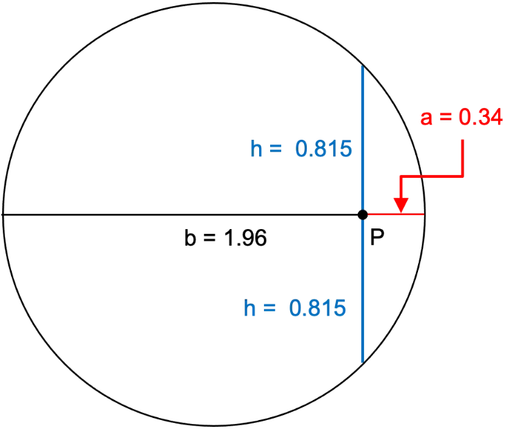

Illustrative example
Given two straight line segments, ##b = 1.96~##pu* and ##h=0.815~##pu, draw the unit length segment ##a## in pu such that one segment is the square root of the other.
Construction
1. Draw given horizontal segment ##b## (black).
2, At its right end (point P), draw two vertical segments of length ##h## (blue) one up and the other down.
3. Draw a circle defined by three points, the one free end of segment ##b## and the two free ends of the two segments ##h##.
4. At point P, extend segment ##b## until it intersects the circle. The extension segment (red) is the required unit segment ##a.##
Numerical verification
The measured length of unit segment ##a## after construction is ##a=~##0.34 pu.
In this case ##b## is longer than the geometric mean ##h##, therefore ##h## is the square root. Its units are already pu and if I square it, its units will be pu2:
##h^2=(0.815~\text{pu})^2=0.664~\text{pu}^2.##
Now ##b## is given in pu units and needs to be converted to pu2 for comparison. This means multiply by "unit" vector ##a=0.34~##pu:
##b\times a=(1.96~\text{pu})\times(0.34~\text{pu})=0.666~\text{pu}^2.##
Close enough considering that the numerical value for ##a## is given to two sig-figs.

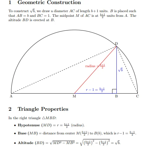

Presumably you can always construct ##\sqrt{b}## by drawing a circle with diameter b+1 and placing a perpendicular at b to intersect the circle. Eg diameter 6 / radius 3 for ##\sqrt{5}##. The right triangle with h as an altitude has hypotenuse ##r=\frac{b+1}{2}## drawn from the centre and base ##r-1=\frac{b-1}{2}## whence ##h=\sqrt{b}## by Pythagoras.
neilparker62 said:
Presumably you can always construct ##\sqrt{b}## by drawing a circle with diameter b+1 ...
I don't think so. In what units would you draw "1" in this construction? Angstroms, centimeters, inches, feet, furlongs, light years, smoots? If you draw it as a fraction of ##b##, how would you choose that fraction?
If you choose to use a ruler with units to draw ##b## (as opposed to a straight edge without units), you might as well draw the square root segment directly in those units.
Once you draw the figure in post #1, you have defined the units ##a## in which ##h## is the square root of ##b##. Furthermore, the figure can be drawn if you are given (on a piece of paper) any two of the three segments involved and all you have is a compass and straightedge with no markings.

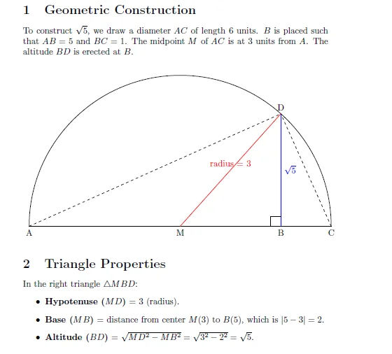

Well here's the construction of ##\sqrt{5}## anyway. Courtesy of Google Gemini.
Gemini has solved the problem "Construct a segment DB that represents the square root of given segment AB when the unit segment is ##~{BC}=\frac{1}{5}{AB}.## The first construction in post #13 is the more general way of doing this.
The bottom line is that there three segments representing (1) a number, (2) the square root of this number and (3) a unit segment. If you are given segments representing any two of the three, you can construct the third. I note that (3), the unit segment, is necessary to make the conversion from "segment representation" to numerical representation.
This point is made clear if similar triangles are used in the Gemini problem. We have the basic relation $$\frac{AB}{DB}=\frac{DB}{BC}\implies AB\times BC=(DB)^2. $$ With ##AB=5BC##, $$5 BC^2=(DB)^2\implies \frac{DB}{BC}=\sqrt{5}.$$ This last expression says that "segment ##DB## expressed in terms of unit segment ##BC## is the dimensionless quantity ##\sqrt{5}.##"
Considering the obfuscatory numero-geometric solution proposed by Google Gemini, I would also add (sorry for gloating) that it also illustrates the superiority of human intelligence over the artificial variety.

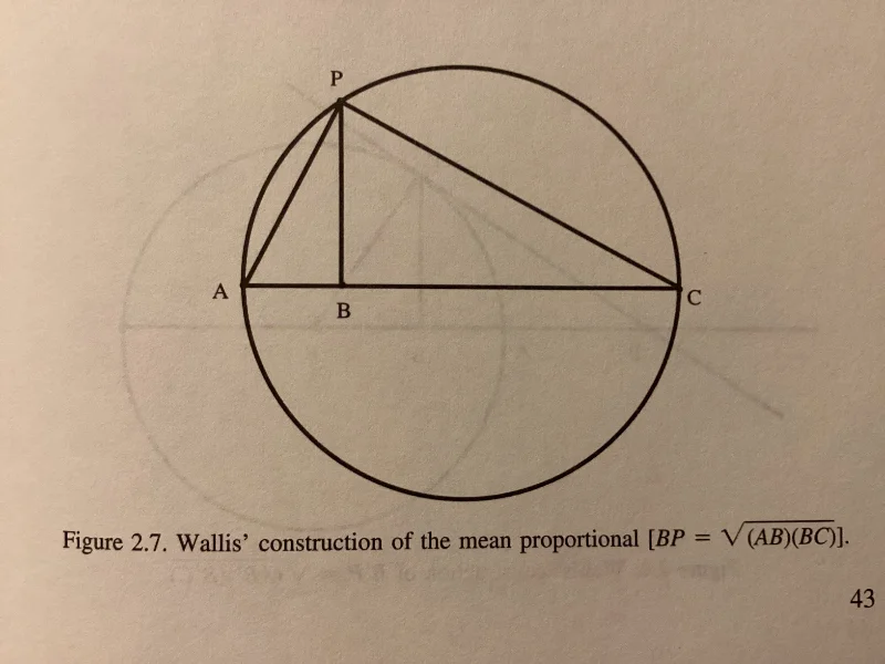

Can you post what John Wallis did in this context? I am not familiar with that.
Wallis was a younger contemporary of Descartes whom he read and greatly admired. He used the figure below to construct the mean proportion ##BP=\sqrt{(AB)(BC)}## for any arbitrary placement of point ##B## between ##A## and ##C## using
$$(BP)^2+(AB)^2=(AP)^2$$ $$(BP)^2+(BC)^2=(PC)^2$$ $$(AP)^2+(PC)^2=(AC)^2$$
Note that triangle APC is always a right triangle.
This image is from the book referenced in post#1.
