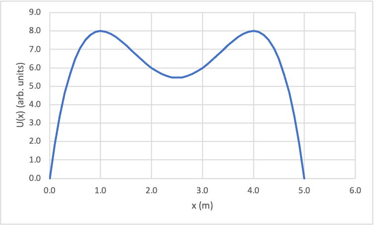

I am not 100% convinced about that and this why. I took your "what's going on" as an invitation to seek physical meaning to the given expression for the velocity. If we assume that there is a single force acting on the particle, then we can derive a potential function for that force. $$\begin{align} & F=ma=mv\frac{dv}{dx}=m(x-1)(x-4)(2x-5)=-\frac{dU}{dx} \nonumber \\ & \implies U(x)=- \frac{1}{2}x^4+5x^3-\frac{33}{2}x^2+20x. \nonumber \end{align}$$A plot of this potential is shown below.
At ##x=1~##m and ##x=4~##m we have points of unstable equilibrium where the potential energy is ##8 ~##units. If the particle has energy (##8-\epsilon##) units, in the limit ##\epsilon\rightarrow 0##, we have turning points at ##x=1~##m and ##x=4~##m. Meanwhile the period of the oscillatory motion increases and becomes infinite when ##\epsilon=0.## Such a potential could be used for example to model how a diatomic molecule vibrates at low energies but falls apart when too much energy is pumped into it. So I think that there could be physical meaning to this and that is why I am not 100% convinced.
BTW, we went through the ##v({dv}/{dx})=0## business 3 years ago here and I think it would be wise to let that sleeping dog lie.
