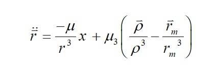

i am trying to solve this equation which take the third body perturbation into account
Equation of acceleration r double-dot = (-mu / r^3) x + mu_3 (rho-vector / rho^3 - r_m-vector / r_m^3), with vector quantities and exponents as printed.
separating each compoent I am left with 3 second order equations for each component with rm as a time dependent variable also, what is the right way to solve this ?
If you have 3 2nd order ODEs you should probably re-write this as a system of 6 1st order ODEs
When you say that rm is a time dependent variable; do you mean that it is an independent variable (no dependence on r) which changes over time?
i meant that the position of the moon is dependent on time, but I guess I can solve them as you guys said as a whole 6 second order coupled equations. I will try that hope it works 🤞
