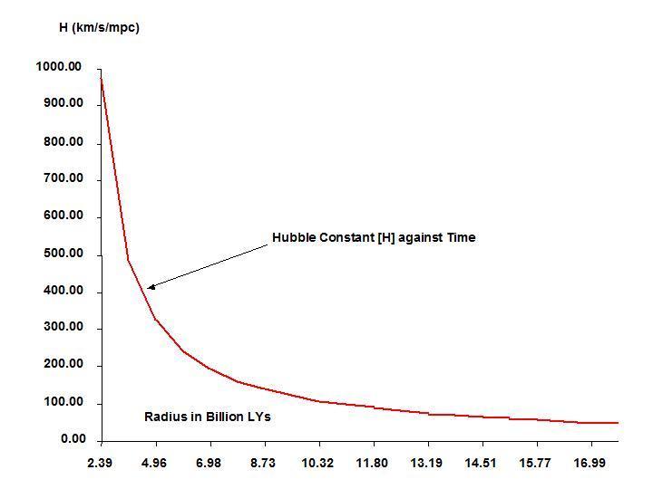

However, I was simply using the Friedmann equation [2] cited in post #3 as a way of approximating the size of the universe against time/radius. So I plugged in the current mass density of homogeneous space and assumed the Hubble radius as a starting point, then extrapolated the radius back to 380,000 years. While this did suggest a radius that was some 1000x smaller than today, I realized that there were a lot of issues with this approximation, i.e. the physical universe is much bigger than Hubble radius etc. Hence my attempt to solicit some help from PF.
In response to your request for specific details I have attached 2 graphs that show the basic results of my spreadsheet, which I understand is flawed, but which I thought reflected that general concept of expansion. On reflection, the whole velocity issue is possibly a bit of a red herring; as I only raised this issue because I was interested in what might happen to the photons in a universe whose expansion slows below [c], i.e. in a big crunch. However, it was probably a mistake to have overloaded my posts with too many issues. Does this help clarify the situation?

... For example, based on my own spreadsheet approximation, the ‘radius’ of the universe at +380,000 years given the relationship between H and density would have to have been in the order of 19 million lightyears.
Again, what do you mean by that expression. We already know that even if it is finite the universe was considerably larger than 19 million lightyears at the time of last scattering.
Any spreadsheet that comes up with a figure like that 19 million seems of dubious value. You may be doing yourself a disservice by not discarding it.
At the time of last scattering the matter that emitted the CMB is estimated to have been 42 million lightyears from our matter. (I mentioned this earlier). 42 is a lot more than 19. And there was plenty more universe out beyond that matter, out beyond that 42. So what you are saying doesn't appear sensible.
" I don’t see how you model an expanding universe without using real radii at some point." WOW! That could be the source of all your problems. If you don't understand that, then you don't understand the role played by the scalefactor a(t) which is the basic measure of the size of the universe used in cosmology!
So that would mean you can't get to first base. You have to keep on using your homebake spreadsheet because it has a measure of the size of the universe which you understand and you can't move on and join in with a conventional approach because you can't grasp how cosmologists gauge the size of the universe. It is a conceptual hang-up! This is a serious problem. If there are more people in your situation then we need some kind of basic sticky-thread message which explains our handle a(t) on the size of the universe. Something that everybody who comes posting here could be expected to have read.

Much appreciated the clarification. I have just posted another thread, which uses the figures verified by Marcus to try and construct a simple model of expansion:
https://www.physicsforums.com/showthread.php?t=267808
The model tries to show the relative energy density of matter, CDM, radiation and dark energy over the period from now back to decoupling. Whether it does this in any meaningful way is what I trying to verify. As I am still very much on a learning curve when it comes to cosmology, I would very much appreciate any further insights you may have on these issues. Thanks
