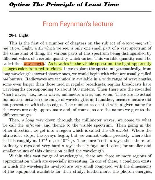

Kindly see the attached pic for the question.
##lambda = {c/v}##
This is the Question: It's from the book: Concepts of Physics by Dr. H C Verma.
The common observation is off course that a red light would appear red even when viewed from under the water (for eg in a swimming pool).
But, in the same book, it's been written that colour depends on wavelength, therefore, as wavelength changes after going in a medium, the colour should change, but it doesn't.
Here's the screenshot of that statement from this book:
Also, in Feynman's lecture, it is written that colour depends on wavelength. Here's the screenshot of that excerpt:
I have read various articles on internet, and there's no consensus as to what does the colour depend on. It just appears to me, that some people on net are insisting that the colour depends on frequency, only because that's what solves the question. But it doesn't make sense. If it's frequency in which the colour depends, then why did Feynman wrote that it's wavelength. And why did H C Verma Sir write the same.
Kindly help. Which does it depend on: wavelength or frequency. Though, according to the formula, ##lambda = {c/nu} ##, it could also be deduced that wavelength and frequency are interrelated. But, then again the same question arises, that why did Feynman and Dr. Verma choose to write that it's wavelength.

Frequency is invariant when light goes through medium. If we feel bluish in pool water, we will know that not frequency but wavelength matters.
If you read carefully what they wrote and you have highlighted,, they both refer to what how light is perceived by a human observer. H C Verma Sir writes "The colour sensation to a human eye is related to the wavelength of light" whilst Richard P. Feynman writes about the "apparent" change in color. They do so to categorize the regions of the EM spectrum, e.g. microwave, visible, etc. on the basis of sensation assuming propagation in vacuum, as @Hill already suggested. I can only guess that those luminaries did not deem it necessary to specify that the medium of propagation is indeed vacuum.
Now for the meat of your question. Let's consider first the classical description of light in terms of oscillating EM waves. Consider the boundary condition at the interface of air and water. Surely you don't believe that how fast the electric field oscillates up down changes while the wave traverses from one medium to the other. So the frequency stays constant whilst the speed changes. This can only mean that the wavelength changes, not the frequency.
This brings me to what is your eye sensitive, wavelength, frequency or something else? A simple experiment would be to compare the color of an object in air and at the bottom of a pool with your head under water and your eyes open. You will see no color change.
So is the conclusion that the color perception depends on frequency? I think not. In the quantum description of light, a photon is absorbed and its energy is transduced by the appropriate receptor to an electrical signal that is interpreted by the brain as a specific color. If I had to answer the question in the title of this thread, I would say that (the perception of) color depends on neither wavelength nor frequency; it depends on photon energy, ##\epsilon=\hbar \omega## which is independent of the propagation medium.
This effect is consequence of different absorption rates of different light wavelengths by water.
