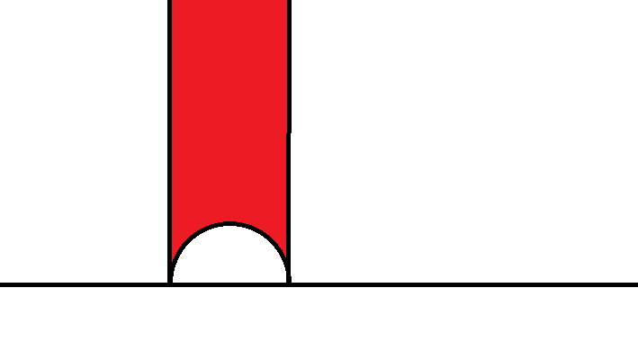

Okay, I think there can be this type of solution. In hyperbolic geometry, we define ideal triangles as triangles which have sum of angles equal to zero, that is, their vertices are at the boundary of hyperbolic space. In Poincare upper half-plane model, the points on the real line are ideal points, as well as points when ##y \rightarrow \infty##. So we can construct this type of ideal triangle in this model:
This triangle has all angles equal to zero, and putting two of those together, we get the so called ideal quadrilateral who's angles are also all equal to zero.
So the idea when constructing smaller and smaller angles, is that you want the vertices to be closer to the ##x##-axis. In case when all are on ##x##-axis(or in vertical infinity), you get zero angles. This way, you can even adjust the sum of angles however you like, since you can slowly deform the ideal triangle(or quadrilateral) so that the sum of angles becomes greater than zero and as big as you want it to be(of course, always smaller than ##2\pi## radians). Hope this helps some more.

This is perfect! Thanks so much. Makes sense. I didn't consider sending y to infinity. Good day, my friend!

FYI, attached is another option.
Yeah, all vertices can be on the ##x## axis, as well. Good work!
