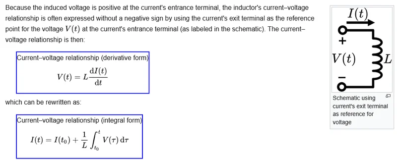

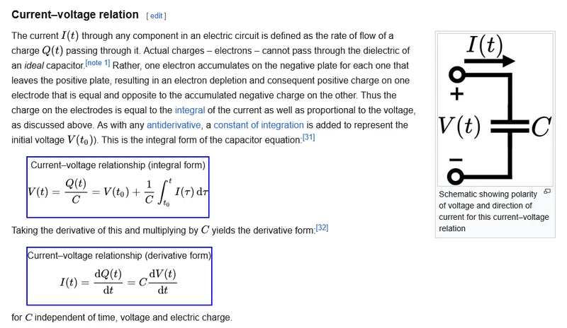

You will use Differential Equations a lot in Engineering Physics. For example, you will analyze electronic circuits that have inductors and capacitors in them using Differential Equations that describe the voltages and currents and how they vary with time.
https://en.wikipedia.org/wiki/Inductor
https://en.wikipedia.org/wiki/Capacitor
