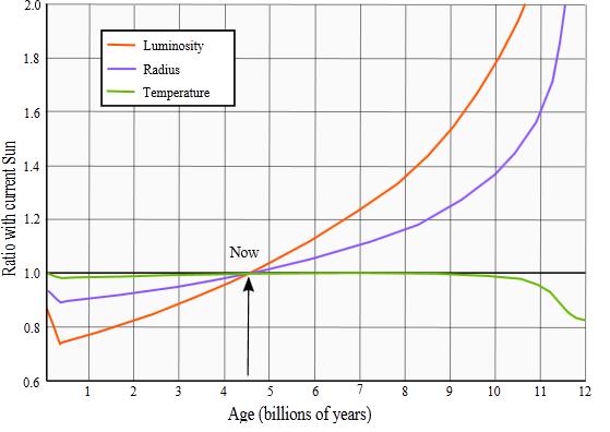

JohnPrior3 said:
So I am working on making a simulation that shows the habitable zone of our solar system from now until our sun reaches the end of it's red giant phase. The sun will die when it is 10 billion years old and will reach the end of the red giant stage at 5 billion years. I know the habitable zone will be between 50-70 AU at the end of this timeline and the sun will be 256 times bigger than it is now, but how long will Earth to leave a habitable zone? Also, does anyone know how quickly the sun will increase in radius during it's red giant phase? Before it dies, it will be 1.37 it's current size. How will the sun change from now until then in terms of luminosity and temperature?
The luminosity of the sun will increase faster than its radius.
L = 4πr2σT4
Where:
r = The radius of the star, in meters;
σ = The Stefan-Boltzmann constant, with a value of 5.670373(21) × 10−8 W m−2 K−4; and
T = Effective surface temperature of the star, in Kelvin.​
As a result, the habitable zone will gradually be pushed further away from the sun as it ages.
In another ~1.1 billion years, the sun's luminosity will be 10% greater than it is now, while the sun's radius will only have increased by 5%. According to Kopparapu et al. (2014), that would put Earth right at the inner edge of the conservative habitable zone (0.997 AU).
To make things even more complicated, as the sun ages it will also lose mass. Which means that the orbits of all the planets will gradually be extended outward, away from the sun.
Source:
Habitable Zones Around Main-Sequence Stars: Dependence on Planetary Mass - arXiv : 1404.5292v2 [PDF]
