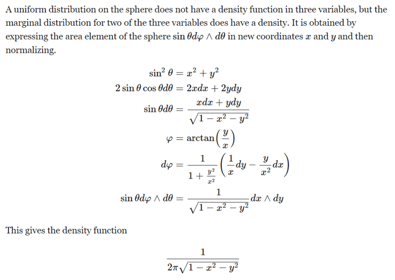

Anyway, I'm somewhat lost on how to continue. I'm attaching a partial solution to the problem. I have several question marks.
  1. Overall, I don't understand what they are doing. Why express ##\sin^2\theta## as ##x^2+y^2##? What is the approach they are taking?
  2. I'm not very familiar with wedge products, and I think they use these. However, isn't an area element of the unit sphere simply ##\sin\theta d\varphi d\theta##? Why write ##\sin\theta d\varphi\land d\theta##?
  3. In the third line of the displayed equations, they have divided by ##2## and ##\cos\theta##. I believe they express ##\cos\theta## as ##\sqrt{1-x^2-y^2}##. But we have ##\cos^2\theta=1-\sin^2\theta=1-x^2-y^2##, so ##|\cos\theta|=\sqrt{1-x^2-y^2}##. Note the absolute values. Hence I do not understand what happened in the third equation.
  4. Lastly, I don't really understand why ##(X,Y)## has a density? Or ##X##?
Grateful if someone could comment on this, or help in some way with the problem.
  • Derivation of the density of a uniform distribution on the sphere: sin^2 θ = x^2 + y^2, differentials, arctan for φ, wedge product sin θ dφ ∧ dθ = dx ∧ dy / sqrt(1 − x^2 − y^2), ending with density 1/(2π sqrt(1 − x^2 − y^2)).
  1. They are expressing ##\sin^2\theta## in terms of ##x## and ##y##. The aim is to differentiate it to obtain the differential of the coordinate function ##\theta##. As it (happily) turns out, the differential of ##\sin^2\theta## contains the product of ##\sin\theta## and ##d\theta##, which appears directly in the area form. Once they have divided by ##\cos\theta = \sqrt{1-x^2-y^2}## they have ##\sin\theta \, d\theta##.
  2. ##d\theta \wedge d\varphi## is an area form - a differential 2-form (a ##p##-form is a fully antisymmetric (0,p) tensor). You can think of it as a directed area element. It takes two vectors (on the sphere) as argument and returns the area spanned by those vectors. In the theory of integration of differential forms, the vectors plugged into the differential forms are the tangent vectors of the coordinate lines corresponding to your integration coordinates. This is why, when you use coordinates ##\theta## and ##\varphi##, the scalar area element becomes ##\sin(\theta) d\theta\, d\varphi##. The mathematics of the wedge product of differentials will directly give you the Jacobian determinant when you perform a coordinate change. What you need to remember is essentially that the wedge product is fully antisymmetric. (You will need this when taking the wedge product ##\sin\theta \, d\theta \wedge d\varphi##)
  3. You can restrict yourself to the upper half of the sphere for which ##z \geq 0## (i.e., ##\cos\theta \geq 0##). By symmetry the lower half of the sphere will give the same density in the x-y-projection. You will anyway normalise the distribution in the end.
  4. They have changed to parametrise the sphere by the ##x## and ##y## coordinates. The area form in the ##x##-##y## plane is just ##dx\wedge dy## so whatever multiplies this is the density in ##xy##. To find the density in ##x## only you must marginalise ##y##.
Edit: Note their typo ##d\varphi \wedge d\theta## instead of ##d\theta \wedge d\varphi##. Normally I would suspect the typical mathematician case of using the opposite convention for which angle to call what, but this is contradicted by the ##\theta## in the sine argument. It is also easy to check that their wedge product would have the opposite sign if they actually had ##d\varphi \wedge d\theta##.
Ok, thanks a lot.
After having computed this myself, I think there's a typo in the solution I attached, or? They write $$\sin\theta d\varphi\land d\theta=\frac1{\sqrt{1-x^2-y^2}}dx\wedge dy,$$ however I claim it should be $$\sin\theta d\varphi\land d\theta=\frac1{\sqrt{1-x^2-y^2}} dy\wedge dx,$$i.e. instead of ##dx\wedge dy## we have ##dy\wedge dx##. We have\begin{align}\sin\theta d\theta&=\frac{xdx+ydy}{\sqrt{1-x^2-y^2}} \nonumber \\ d\varphi&=\frac1{1+\frac{y^2}{x^2}}\left(\frac1xdy-\frac{y}{x^2}dx\right)=\frac{x^2}{x^2+y^2}\left(\frac1xdy-\frac{y}{x^2}dx\right) \nonumber \end{align} So, \begin{align}\sin\theta d\varphi\wedge d\theta&=d\varphi\wedge\sin\theta d\theta \nonumber \\ &=\frac{x dy}{x^2+y^2}-\frac{y dx}{x^2+y^2}\bigwedge \frac{xdx}{\sqrt{1-x^2-y^2}}+\frac{ydy}{\sqrt{1-x^2-y^2}}\nonumber \\ &=\frac{x^2}{x^2+y^2}\frac{1}{\sqrt{1-x^2-y^2}}dy\wedge dx-\frac{y^2}{x^2+y^2}\frac{1}{\sqrt{1-x^2-y^2}}dx\wedge dy\nonumber \\ &=\frac{1}{\sqrt{1-x^2-y^2}} dy\wedge dx\nonumber.\end{align}

I think I'm starting to understand this more and more (although I must confess, I really believe the problem is meant to be for the unit ball, but whatever, this is also an interesting problem!). I'm trying to formulate the problem into an equation where we want to find the unknown density; I'm tempted to write $$\iint f(x,y)\,dxdy=\iint \sin\theta \,d\theta d\varphi =1,$$where the coordinates in the latter integral are the spherical coordinates, and say we want to find ##f##, which then should be the Jacobian of that transformation. But is this correct? After all, spherical coordinates are a 3-dimensional thing, so I'm not sure where ##\theta## and ##\varphi## "live", or how to write down the relationship between ##x,y## and ##\theta,\varphi##.
Spherical coordinates are generally three-dimensional. However, restricting r to be fixed, you have a two-dimensional coordinate system for the sphere of the fixed radius.
Yes, you can do it like that with the Jacobian, but using the wedge product does that essentially for you.
