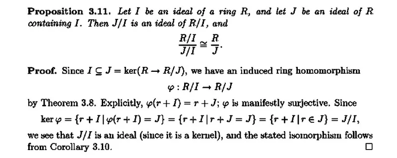

Printed textbook proof of Proposition 3.11: for ideals I contained in J of a ring R, J/I is an ideal of R/I and (R/I)/(J/I) is isomorphic to R/J, via the induced homomorphism r+I maps to r+J.

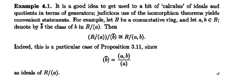

Textbook excerpt, Example 4.1: (R/(a))/(b̄) ≅ R/(a, b), with the statement that b̄ = (a, b)/(a) as ideals of R/(a).

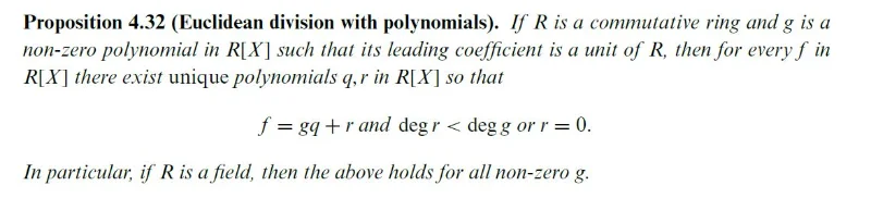

Printed text of Proposition 4.32 (Euclidean division with polynomials): for commutative ring R and non-zero g in R[X] with unit leading coefficient, every f in R[X] equals gq + r with unique q, r, where deg r < deg g or r = 0; in particular for fields and all non-zero g.

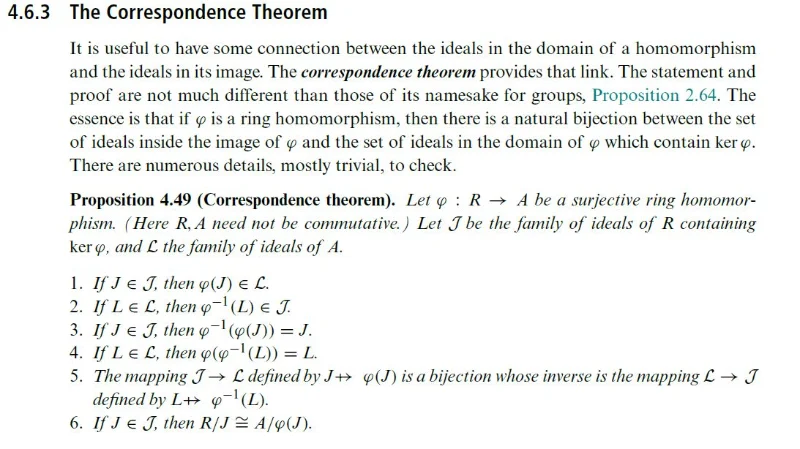

Textbook page titled 4.6.3 The Correspondence Theorem, with Proposition 4.49 listing six statements about a surjective ring homomorphism phi: R to A and the ideal correspondence between R and A.

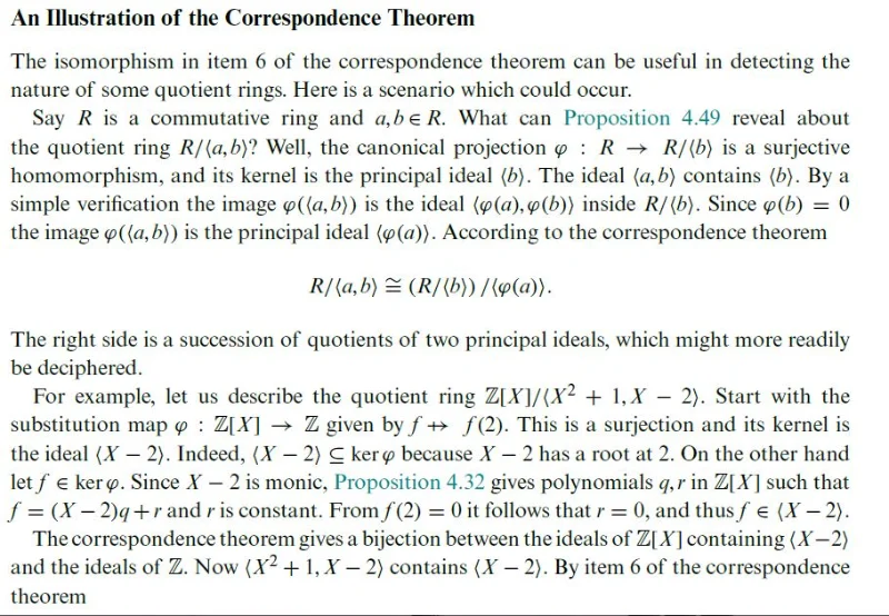

Printed page titled An Illustration of the Correspondence Theorem, showing the isomorphism R/(a,b) ≅ (R/(b))/(φ(a)) and an example computing Z[X]/(X^2+1, X-2) via the substitution map f ↦ f(2).

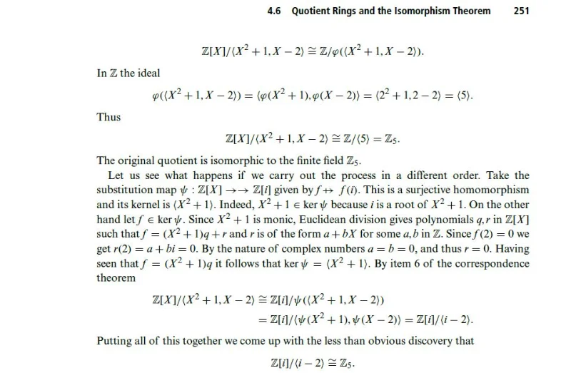

Textbook page 251, section 4.6, showing Z[X]/(X^2+1, X-2) isomorphic to Z/(5) = Z_5 via the ideal phi((X^2+1, X-2)) = (5), then a second route through Z[i]/(i-2) isomorphic to Z_5.
Given a homomorphism ##\varphi:R\to A##, in the case of ideals in commutative rings, if I want to determine what the quotient ring ##\frac{R}{\langle a, b\rangle}## is isomorphic to, in the first two screenshot from the Aluffi's text, he states that reader can make use of Proposition 3.11, the third isomorphism theorem. His justification is that: ##frac{\frac{R}{(a)}}{(\bar{b})}\cong\frac{R}{(a,b)}\quad (\bar{b}=\frac{(a,b)}{(a)}.##
However, in the next four screenshots, from Lawrence and Zorzitto's text, they suggest to the reader that the fourth isomorphism or the Correspondence theorem can be used due to the following reasons: ##\frac{R}{\langle a, b\rangle}\cong \frac{\frac{R}{\langle b\rangle}}{\langle \phi(a)\rangle}##. The example they gave is that of ##\frac{\Bbb{Z}[x]}{\langle X^2+1, X-2\rangle}##.
Am I to conclude that say if I need to cite a reasons for resolving which other ring a quotient ring##\frac{R}{\langle a, b\rangle}## is isomorphic to, I can cite either the correspondence theorem or the third isomorphism theorem?

By the (second) isomorphism theorem, e.g. 3.11, we get

The ring ##R/J## consists of all integer polynomials where we have identified ##x=2,## leaving us with an isomorphic copy of ##\mathbb{Z}.## Now, what ring is ##\left(I+J\right)/J?## We know that ##J/J=\{0\},## but ##J\not\subseteq I,## so we cannot build ##I/J.## Instead, we have to take all polynomials in
I+J=\mathbb{Z}[x]\cdot(x^2+1)+\mathbb{Z}[x]\cdot(x-2)
modulo ##x-2.## This means we replace all occurrences of ##x## by ##2## and get polynomials from ##\mathbb{Z}[2]\cdot 5=5\cdot\mathbb{Z}.## Thus,
R/\left(I+J\right)\cong \mathbb{Z}/5\mathbb{Z}\cong \mathbb{Z}_5.
The second process simply exchanges the roles (definitions) of ##I## and ##J.## Here, we have
\begin{align*}
R/\left(I+J\right)&\cong \left(R/I\right)/\left(\left(I+J\right)/I\right).
\end{align*}
The ring ##R/I## is isomorphic to ##\mathbb{Z}[\mathrm{\,i\,}].## So what is ##\left(I+J\right)/I?## We still have all polynomials
which we now take modulo ##x^2+1.## The first term vanishes, and the integer coefficients of the second term become ##\mathbb{Z}[\,\mathrm{i}\,]## plus that we then have to consider the ideal ##I+J## modulo ##x^2+1,## i.e., we set ##x=i,## turning ##\left(I+J\right)/I## into an isomorphic copy of ##\mathbb{Z}[\,\mathrm{i}\,]\cdot (i-2)## and finally
R/\left(I+J\right)\cong \mathbb{Z}[\,\mathrm{i}\,]/ \mathbb{Z}[\,\mathrm{i}\,]\cdot (i-2).
Both statements together result in
R/\left(I+J\right)\cong \mathbb{Z}[x]/\bigl\langle x^2+1,x-2 \bigr\rangle \cong \mathbb{Z}/5\mathbb{Z}\cong \mathbb{Z}_5=\mathbb{Z}/\bigl\langle 5 \bigr\rangle \cong \mathbb{Z}[\,\mathrm{i}\,]/ \mathbb{Z}[\,\mathrm{i}\,]\cdot (i-2)=\mathbb{Z}[\,\mathrm{i}\,]/\bigl\langle i-2 \bigr\rangle .

@fresh_42 in my original post, in screenshot 2, where it says
##\bar{b}=\frac{(a,b)}{(a)}.\\\\##
In the context of ##\frac{\Bbb{Z}[x]}{\langle X^2+1, X-2\rangle}
\cong\frac{\mathbb{Z}}{\langle i-2\rangle}\cong \mathbb{Z}_5,\\\\##
Can we show ##\bar{X-2}=\frac{\langle X^2+1, X-2\rangle}{\langle X^2+1\rangle}.\\\\##

@fresh_42 you know in the third isomorphism ##(R/I)/(I/J)\cong R/J##, ##R=\Bbb{Z}[X], I=\langle X^2+1, X-2\rangle, J=\langle X^2+1\rangle, b=\langle X-2\rangle.## According to example 4.1 in screenshot 2,, then ##\bar{\langle b\rangle}=\bar{X-2}= \langle X^2+1, X-2\rangle/\langle X^2+1\rangle.## I am not sure how to remove the italics in my previous reply.
